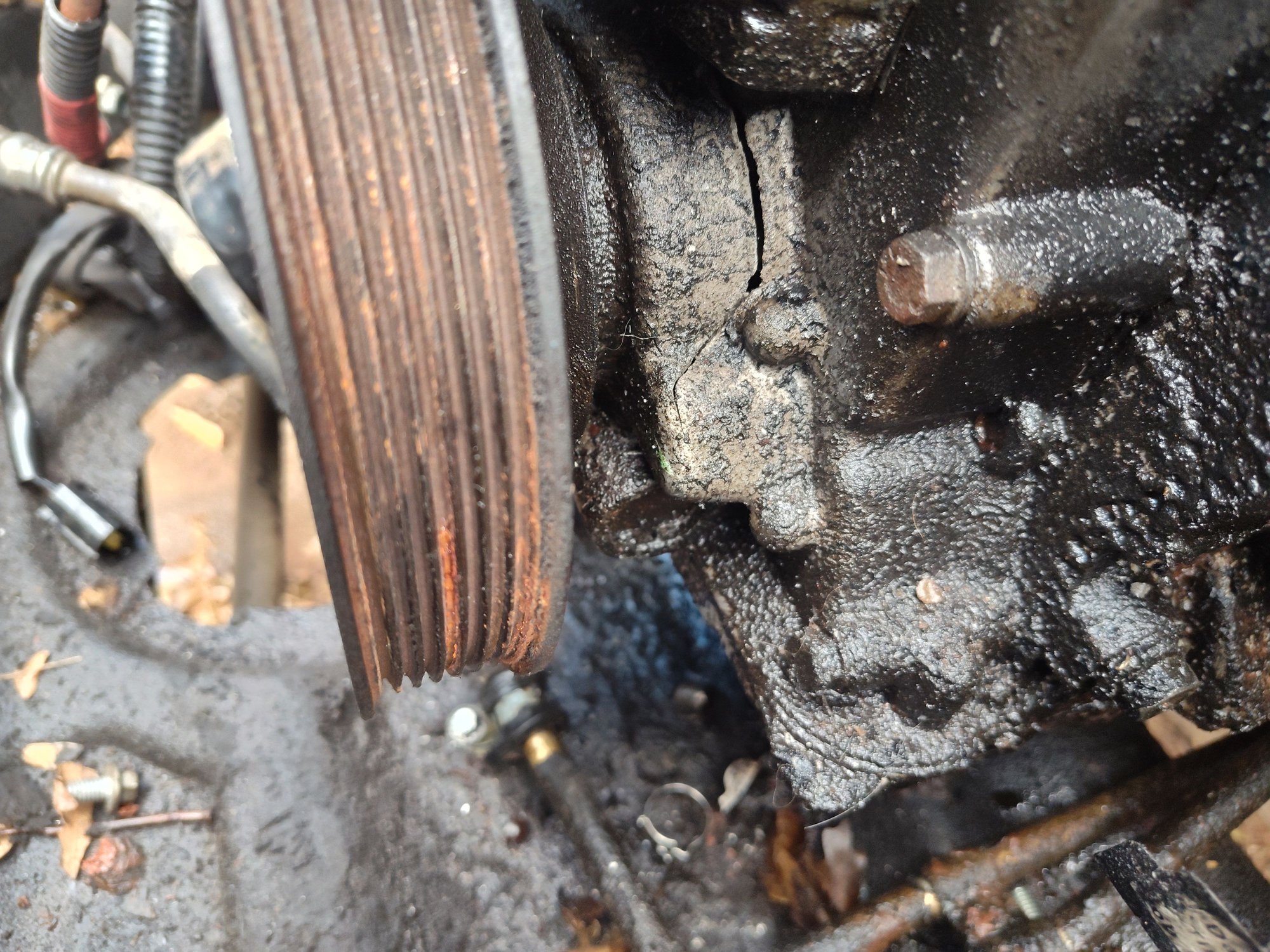

I have an 03 I'm currently parting out. Has 85,xxx miles. Cracked timing belt housing directly above the crank pulley due to the misaligned dowel. Not a repairable issue.

Obviously I'm going to tear down to verify a dowel alignment issue but, this 03 is in the dreaded stay away vin range. This crack doesn't build confidence. Event at 800 I would have walked away if it was for the mint interior and the fuel tank I needed for the 99
