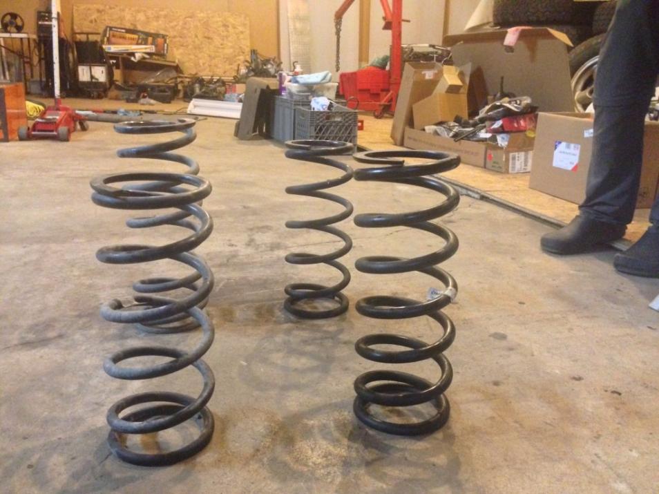

I left the best until last. Jahn@rovinrovers called me last week to let me know he'd found a dangerous situation with the OME lift, installed by the previous owner. a new set of properly matched springs from Expedition Exchange later and i now have a good riding truck with a 2" lift instead of the overly tall 4" mess that he uncovered.
Pics tell a thousand words. here's the springs taken off of the truck. Thats a 781 AND a 751 on the front. The rear was also mismatched with a set of 2" spacers, not pictured being used in an attempt to make the rear as tall as the front. What a mess!
I now have 779's on the front and 762's on the rear. much, much better. The truck sits about 2" shorter at the front than with the previous springs and the truck finally sits level. Maybe i can even fit in a parking garage now ?

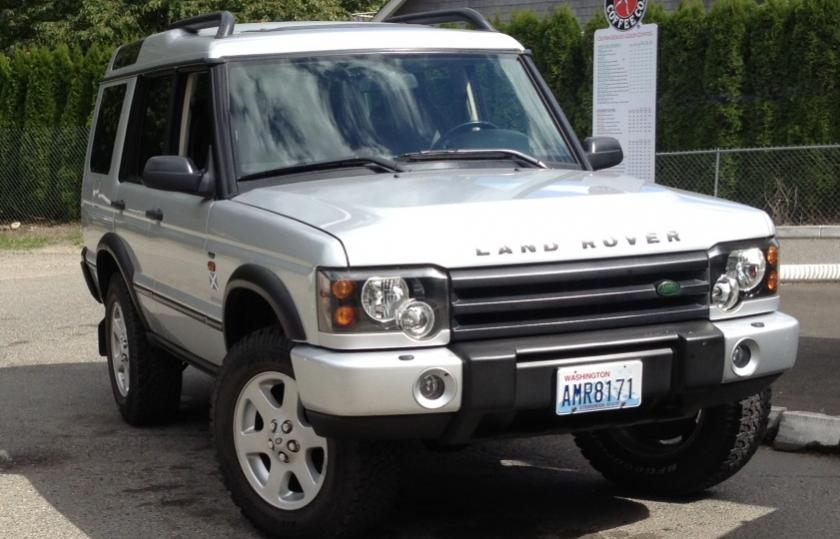

I just picked up a Safety Devices Rack for a Disco 2. Now that my truck is running strong, i can finally start building it for some long delayed road trips!

779's with 762 rear's will not sit 2"s low in the front, that combination will normally sit within q 1/4 to a 1/2" low in the front which can be corrected still with a set of 1/2" isolators.
Might want to talk to your mechanic and have him actually measure the front and rear heights.

Hi Mike, you're correct, i think the intent of my statement got lost there. The truck now sits level.
2" lower was actually referring to how much lower the front of the truck is from previous state. With the previous mismatched springs on, the front of my truck was nose pointed to the sky. The handling was compromised as a result. I was originally planning on holding off on springs until i got the front bumper and winch installed, but with the cost of springs only being $300 at Expedition Exchange it would have been negligent not to get them swapped out once i discovered the problem.
I'm now running a standard OME 2" lift with their Heavy duty springs, approximately 2" lower than the disaster that was on the truck previously. It really was a mess. I forgot to mention the drive line and brake fluids. We replaced all of the fluids on this service to get a proper baseline for service on the vehicle. There were some other miscellaneous things that i took care of too, but neglected to mention.
My learning here, never take basic things for granted. my disco doesnt fit in my garage so on the few occasions i've been underneath (one of them to check the spring types), i never checked each spring. I just looked at what was on one side on the front and one side on the back and ASSUMED that noone would be dumb enough to put on a mismatched set.

Seriously right ? At first i thought they'd just screwed up and put a rear spring on the front and the front on the rear on one side, but the springs don't constitute two correct sets.

By the way, the 751 springs are from a D1 and will give a D2 an extra inch over the 779's. I run 751's and 762' with D1 coil seats and it sets nice and level course I have 240 pounds of winch, bumper and dual batterys to level it out.

I'd have kept the 751's if there were two of them on the truck, but there's only one. They "paired' it up with a 781 on the front.
