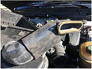

So part of my Air Filter Housing is broken...attaching pic....its the hose that runs from box up to and bolts to driver side front panel on the inside. Mine has started tearing apart, trying to figure out part # for just the hose as I am told it can be replaced without replacing entire air filter housing.

Duct tape... no part number necessary

Anyone know where to buy this part? I threw mine away and am now beating myself up for it. I can't believe I didn't consider using duct tape to repair it.

I don't think it's available at all.
Abran has a plastic replacement in the works right now, and hopefully they'll be for sale in a month or so.
So, duct tape, and an empty oil quart will work in the meantime.
Given how the old ones fall apart, finding a decent used one is almost, if not impossible.
PM Abran, and he'll give you details.
There are several of us waiting to buy one from him.

Lol yeah, im the guy in the thread begging him to take my money. I think I am going to put a new quart bottle on, mine is not doing so hot right now.

Go on ebay and buy a 3.5 inch x 8 inch or 10 inch long turbo silicone tube. They're about $10 with free shipping. I trimmed mine down to about 5.5 inch long or so. Nothing exact. Fits perfect. Good luck.

That's awesome, will that be able to stretch over the openings?
I found this: https://www.ebay.com/itm/3-5-ID-8-LO...5aVcw4&vxp=mtr

Yes that will work. It looks just like the one I ordered.
This one is a little cheaper. This is what I ordered.
https://www.ebay.com/itm/3-5-X-8-STR...item2c701b92f5

Thanks! I ordered a similar one from amazon just because the shipping tends to be faster. Appreciate it dude, I will post up some pics when its done.

Flexseal, gauze, flexseal, gauze repeat.
