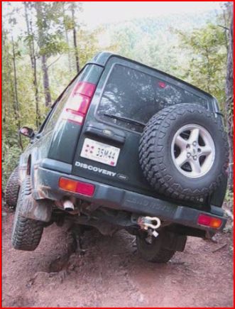

I've got the 2" RTE lift w/OME shocks and running 265/75/16 Hankook M/T. No problems with rubbing on the trails, but I haven't disconnected my sway bars.
Attached Thumbnails 245 vs 265/75r16?  Rub? Power? Flex?-hiking.jpg

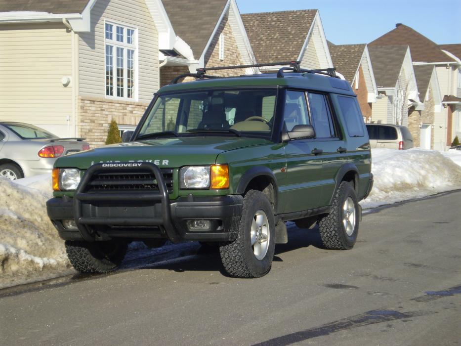

Early pictures of the then newly installed OME 2inch lift and General grabbers AT2 in 265/70r16. To give you an Idea of the clearance and fatness. I did the lift before the tires, so couldn't tell you about running this size before the lift.
Attached Thumbnails 245 vs 265/75r16?  Rub? Power? Flex?-p3110100.jpg   245 vs 265/75r16?  Rub? Power? Flex?-p3110107.jpg
