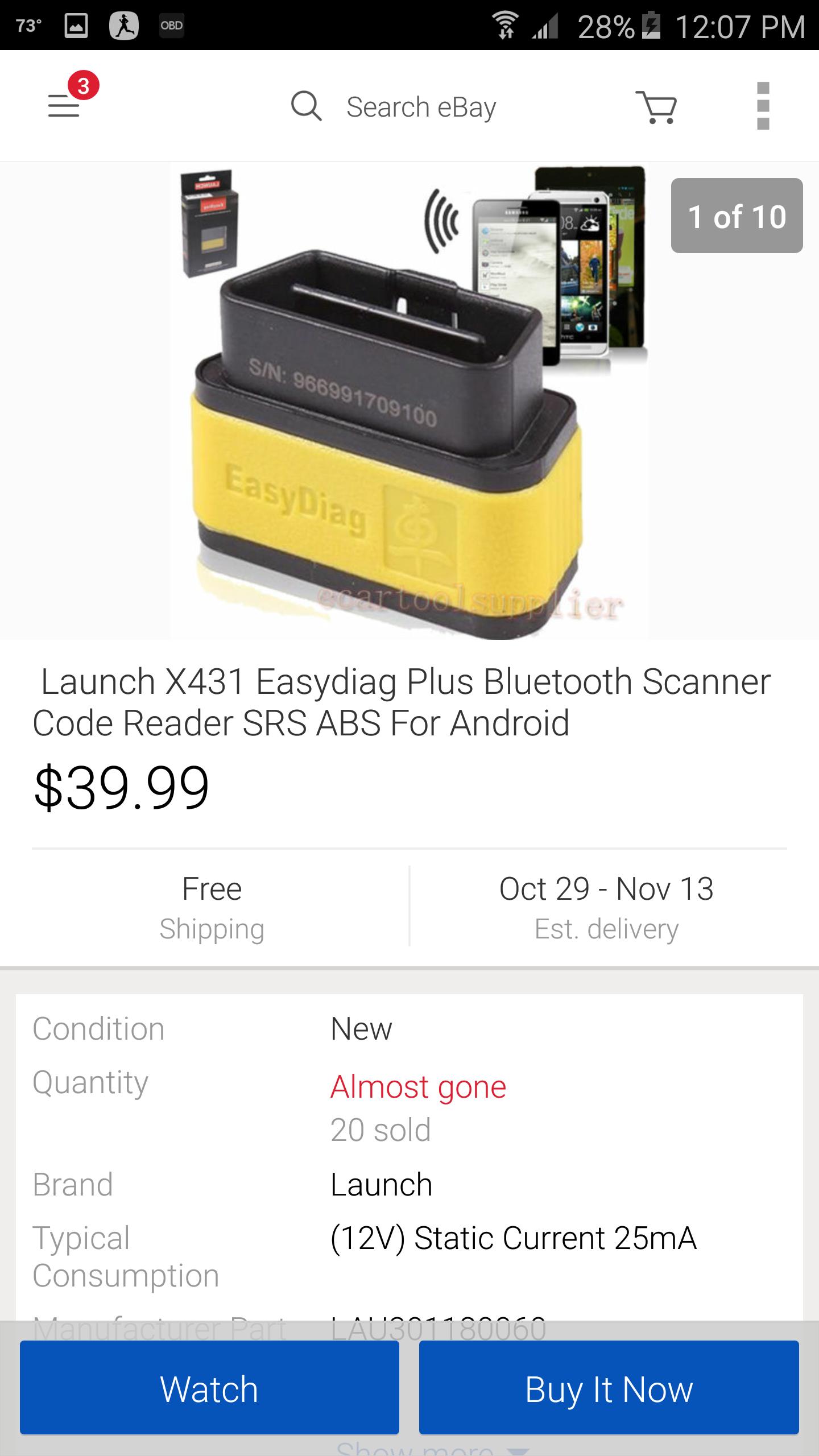

I just ordered one of these to figure out the problem. Cheapest one in the stores(harbor freight/autozone etc) were 130$ or more, so 40$ is not bad at all. Land rover is in the list of the companies this thingy is able to work with.
Attached Thumbnails 3 Amigos ABS Modulator Question-screenshot_2015-10-18-12-07-15.png

Another news, you dont even need to spend 40$ on a reader!
autozone does have them on 'loan a tool'. You give them 140$, get the reader, and they will give your money bck once you return the item in good shape. That is what i am going to do in an hour.

I somehow doubt that the scanner AutoZone has on their loaner program will read our ABS codes....

Definitely post back if you can actually pull your ABS codes with that, but it looks a lot like the $8 scanner I have from Amazon. And as for the AutoZone thing, they do have scanners they will rent you but they won't pull our ABS codes.

You guys were right! I called them in day time and asked strictly for an ABS reader...she said yes, 140$ loaner. So i showed up at the store an hour ago, told her that i am there for the ABS reader, she gave me a device which says obdII on it, i asked again, this is an abs reader right and she said yes. But it was just a regular obdII reader, i have a 5$bluetooth one with Torque on my phone, who would anyone land 140$ for a 10year old obd reader anyway?! I will go back to the store to get my money back. I think i will need to wait until the ebay one arrives
