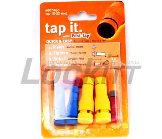

I had problems finding wire taps. I went to O'Reilly and all they had were the in-line clip on type taps. I would suggest look for those while waiting. The smaller screw on type taps. Otherwise a cut and splice will work.

I had these and they are, in my opinion, the best for this application. I admit kind of pricey, but the whole mod is inexpensive. I got these on Amazon for another project and had several spare ones in tool box.
