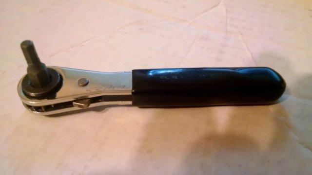

Would this work with correct sized bit?

That should work. You can only get the unit lifted so high because of the brake lines (unclip the lines from the plastic brackets along the firewall for better clearance) and you'll be able to tell when you need to stop lifting. Worst case is the key is too tall to fit underneath. I think 2-inches or shorter should be good. 4mm should be the hex key size.

Thanks, ratcheting holder and bit about 1 1/16". Good to know for when my time comes.
