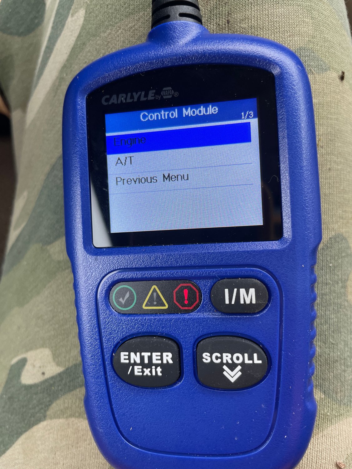

What scan tool are you using? Many scan tools will read engine management codes only, not Land Rover ABS (or other) codes.

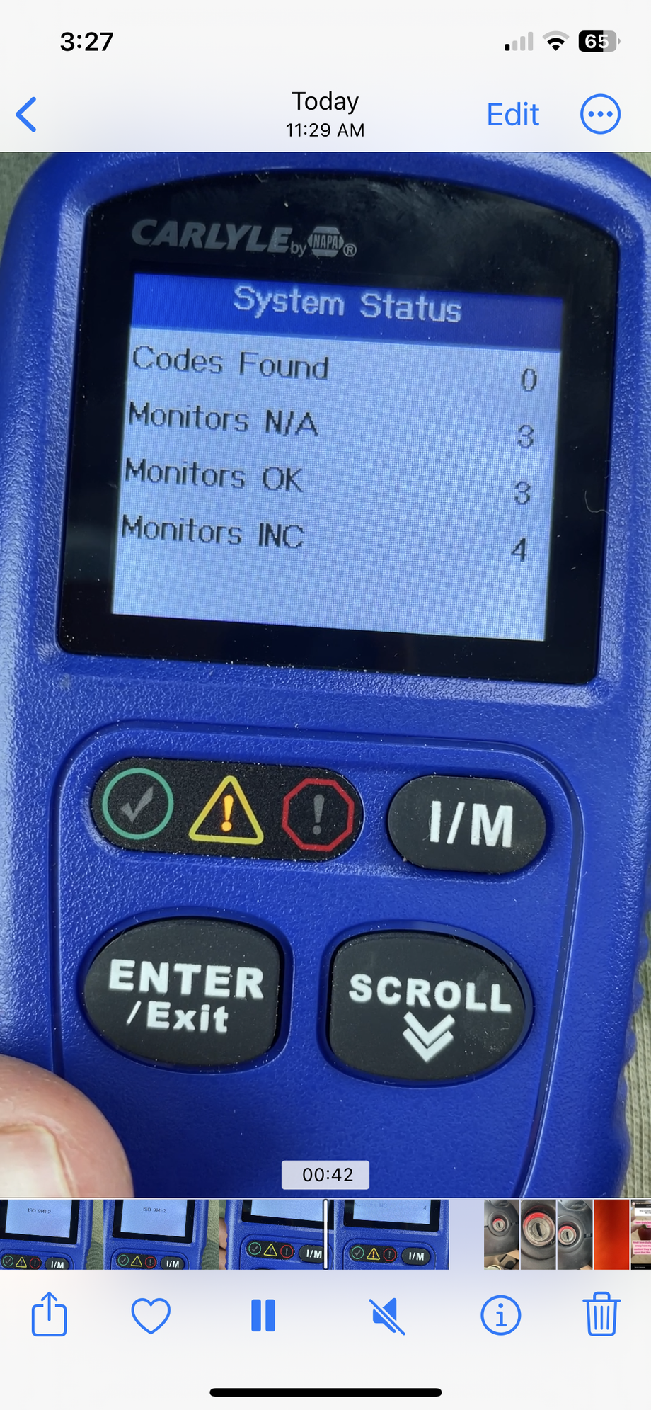

Red light is on but showing no codes (2nd pic)

You're only looking at engine codes, not ABS codes. You need to get hold of something more sophisticated that will show you what's going on in other systems.

When you successfully clear LR ABS faults you will have just the ABS light on upon startup. Then when you move between 5-10MPH the SLABS will see the input from the sensors and turn off the ABS light. If you still have all the fault lights on = you still have stored codes in the SLABS unit or you still have something wrong like a bad sensor, sensor connection.
