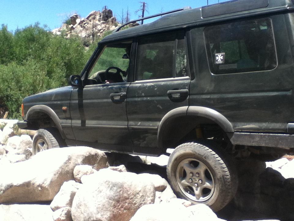

A bit more info. Right now I'm running 265/75/R16 tires with a 2" suspension lift. With that, my modified bumpers and my winch, I do go very far with my rover and can keep up with all my friends in there toyotas and jeeps. Problem is it just keeps up. I have dreams of owning the vehicle that shows up all there rigs and something that has dam near bullet proof components. Don't get me wrong, the stock hardware is decent, but it just gets torn to **** off road. I swap out my diff fluid every 6 months with a heavy grade 5 oil and it always comes out like silver paint.
I attached a photo of my ride with stock wheels on it.
