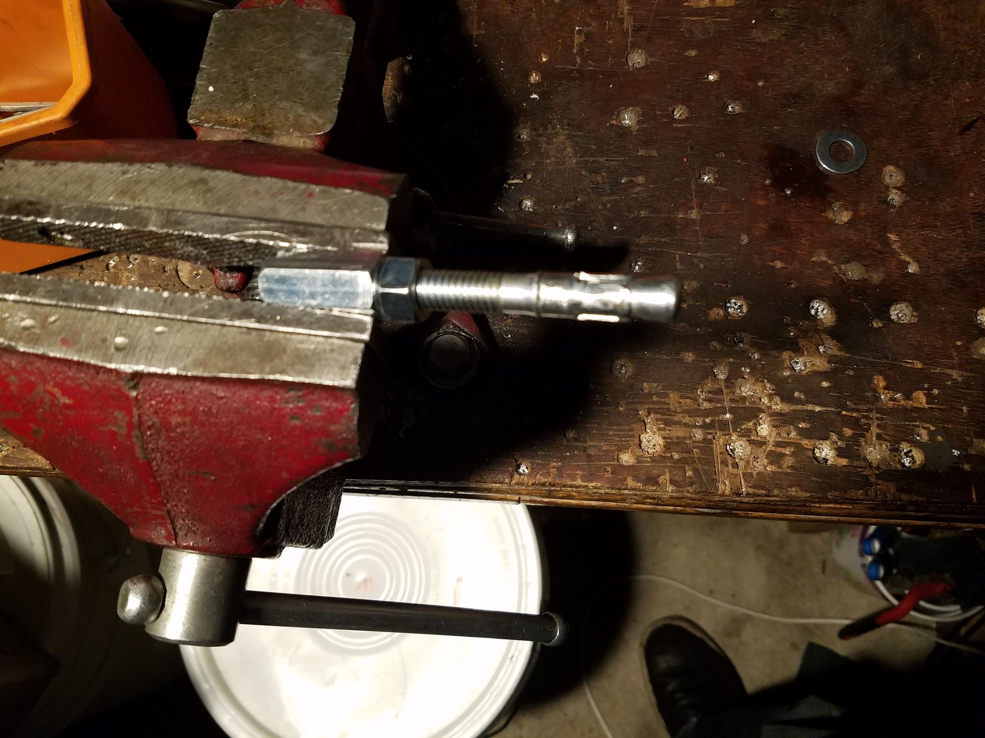

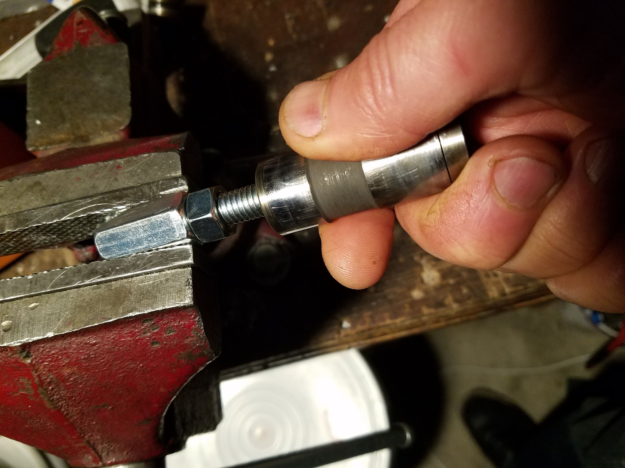

I could get the piston out by letting it soak in WD40 overnight. Then using a wall anchor in a vise to grip the piston from inside. Pushing, wiggling and pulling. There was a lot of black gunky oil in the lower reservoir.
