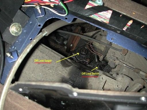

Got me on that one. Mine usually takes a second to come on but always gets to it eventually. Believe there's a switch on the diff that tells the computer when it's locked or not, I'd start there.
Old Aug 4, 2017 | 05:48 PM
MacRoadie's Avatar
Joined: Jan 2017
Posts: 141
Likes: 14
There is. Everything down there get's cooked by the cats and tranny heat and you name it. Plastic gets brittle, contacts go bad
There is also a fuse that energizes that switch and that could be blown.
