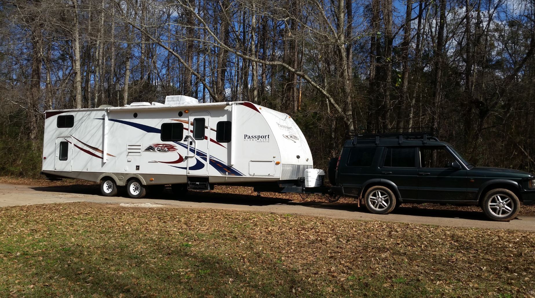

Old Jun 2, 2017 | 12:07 AM
Southern's Avatar
Joined: Sep 2014
Posts: 67
From: GA
You'll be fine...
