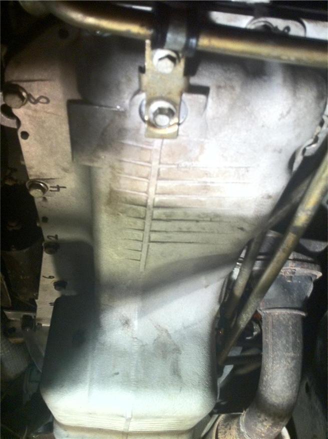

Stopped an Engine oil leak:

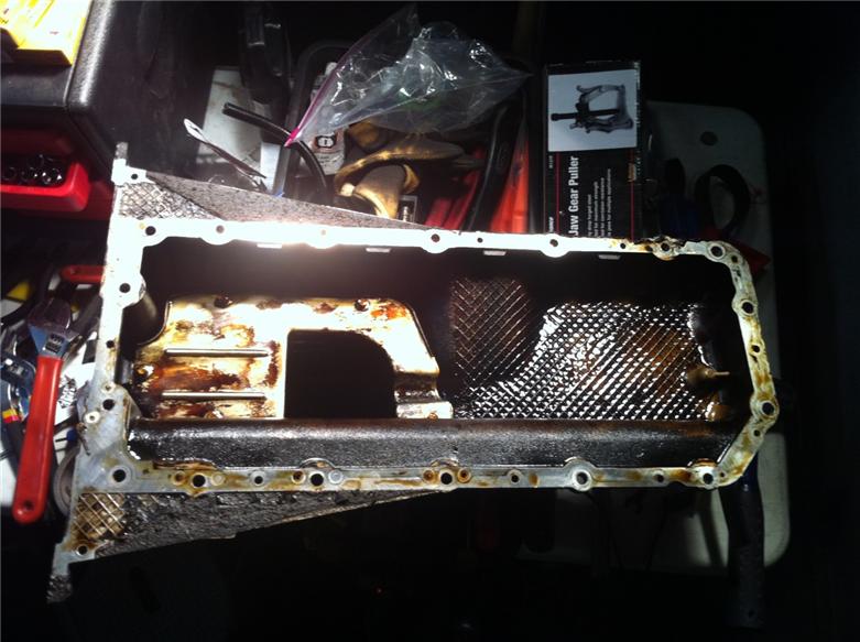

  • Dropped the oil pan, replaced gasket(I have a 2" lift and all for wheels on tire ramps, easy access. A pressure washer with hot water makes quick work of the sediment in the pan & makes it look shiny.

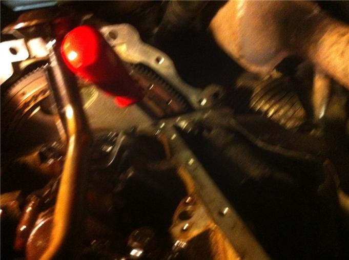

    • Key is to lock your crankshaft with oil pan off with a lever bar on the fly wheel. A 4 ft breaker bar on the harmonic balancer & you win!

Sorry for the blurry picture. Pry bar Lever wedged in the flywheel to remove Crankshaft pulley. (oil pan removed)

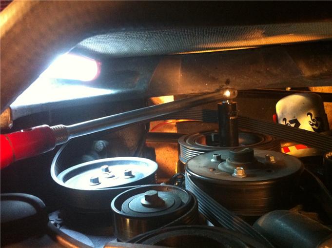

Crankshaft Pulley ready to come off witha 18" breaker bar and 2ft extension

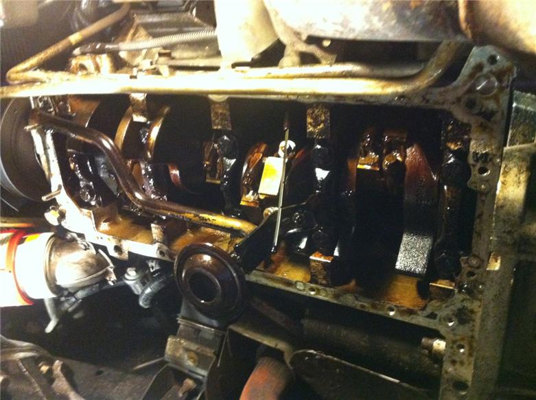

Under bowels of engine block. View with oil pan removed. Thank you Jesus for air rachets and 10" extentions. It makes short work of the 18 or so bolts.
Ok Cleaning the Oil pan in the video. Now its back installed and no leaks. Fired up the disco and let it idle for about 5min oil pressure is good and its back running smooth Whew, it all worked out.

Here is the Oil pan reinstalled and looking good

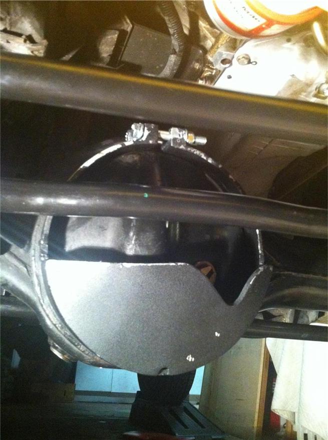

Here is my Diff guard installed and ready for some hits.

That was not hard at all. The key is to isolate the crankshaft from turning. So dropping the oil pan made it really easy. Stick a pry bar in the fly wheel openings. So it cannot turn against the block. You could remove the circle inspection plate on the bell housing and try to shove a pry bar in there. That didnt work for me because there is a flange on the torque converter you cannot get past to reach the fly wheel. It took me about 4 tries to get the pry bar to stick because i was working alone at like 2am, but I finally got it. The crankshaft bolt was relatively easy to come loose. It was well lubed with engine oil for a few years. If you have Harbor Freight close this Pittsburgh Tool pick set is your friend, best $8.99 you'll spend in a while. The 90 degree pick will bring the crank seal out.
