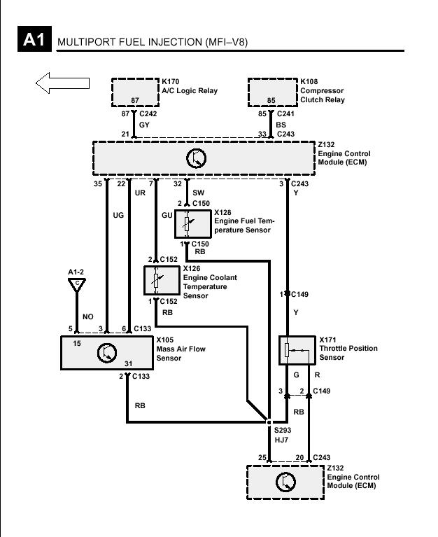

See if this helps any....
All of those sensors are tied together, and it looks like injector power is tied to the MAF. Try unplugging the MAF and starting it.
