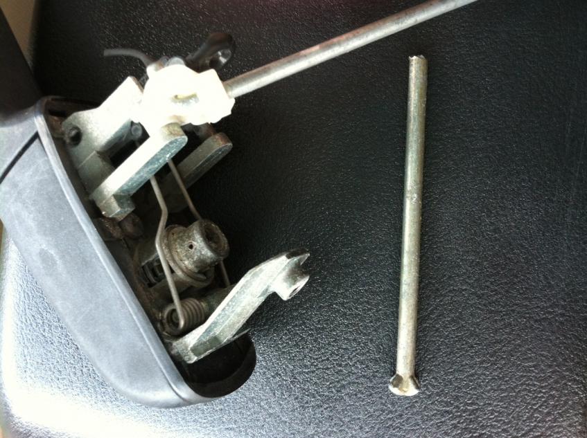

Here's a couple of pictures of the rod I was referring to. The end of it broke off which is where a small pin goes through and holds it in place. The broken off end is still stuck in behind the pin.
FYI - I got a 20D x 4 inch long nail to replicate this rod and re-install. Hopefully it works out well and for the long term.

DiscoIIBrandon - mine broke in the same place.
The nail method works well, providing you can accurately drill and shape it. The metal in a nail is much stronger than those rods, which are actually powdered metal that is pressure/heat formed and very brittle.
Just for insurance, I repaired my old one with some JB weld and stuck it in the glove box, but never ended up needing it. Properly done, a JB weld is going to be just as strong as the surrounding metal, but I liked the idea of a $0.35 fix on my rover...
