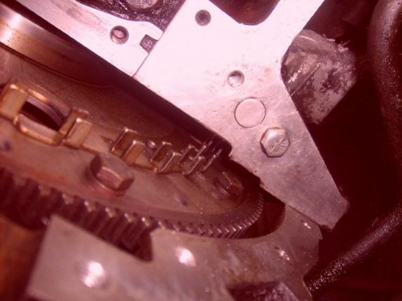

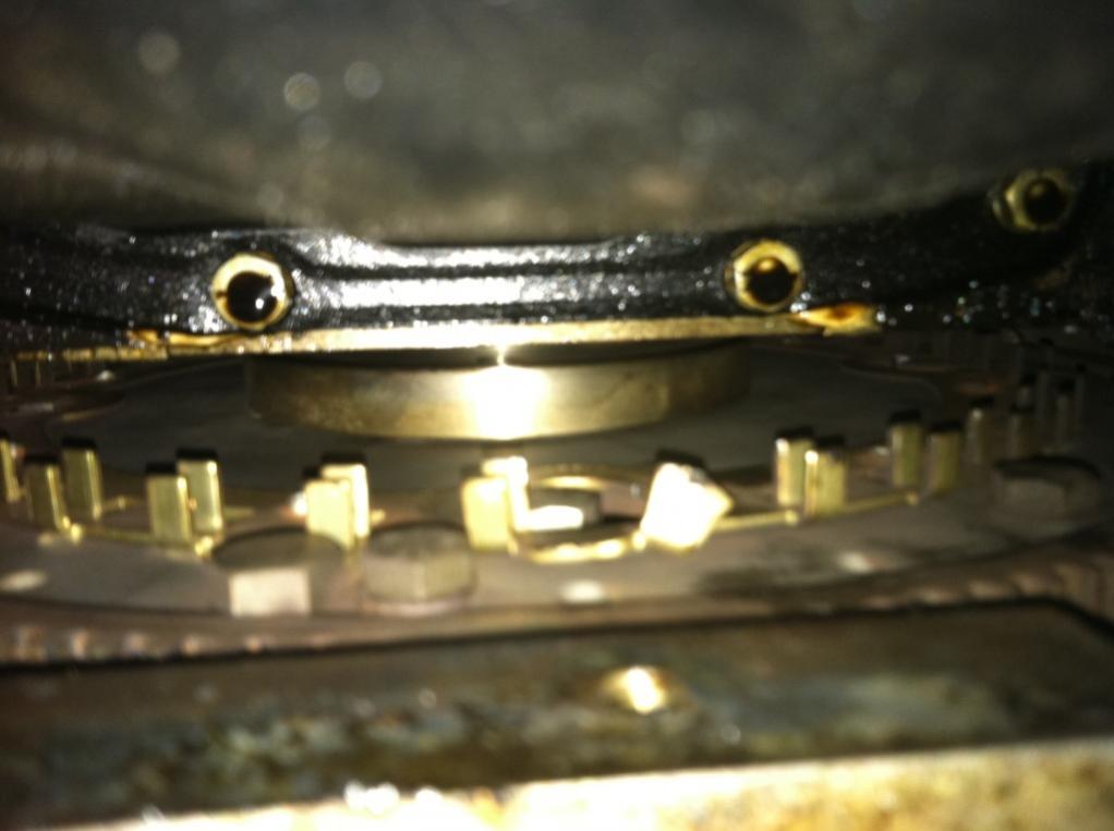

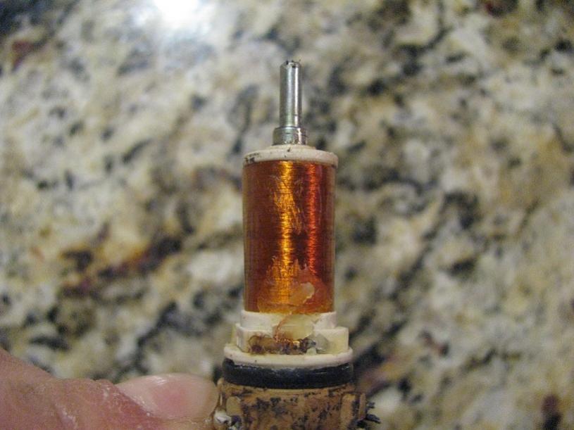

Same problem been hitting my head against the wall. Has spark, has fuel pressure. I sprayed starter fluid into the intake and i would get a backfire once in a while and that is it. It seams that the timing is off but there is no way to adjust the timing on this year.

Timing advance is adjusted per cylinder on the fly by the ECU. It bases that on the crank position sensor. Sensor could have metal "fuzz" on the nose, or you could have bent reluctor teeth. Or jumped timing chain (not too common on this forum).
But even if you have 30 - 34 PSI of fuel pressure, if the injectors are not squirting it.... Should have +12 on one side of every injector, and the ECU switches the ground to it to spray fuel.
But I'm with you, if spark and timing were right should cough along on starting fluid.
