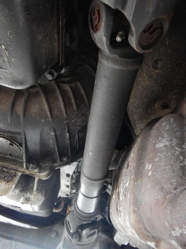

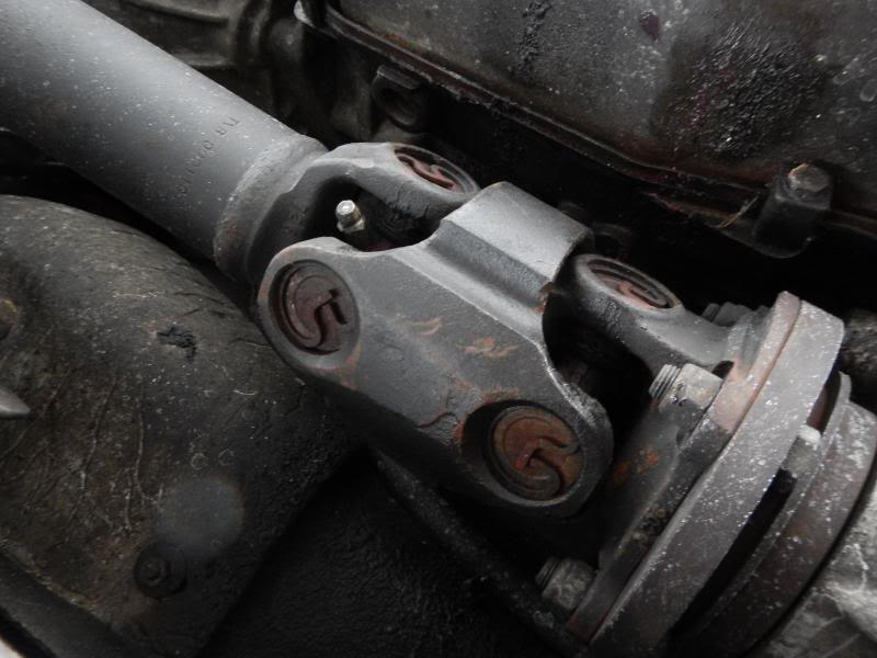

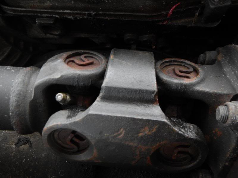

I was able to get the camera under and snap some shots, I am crossing my fingers I am assuming right and it has been done. Take a look and please verify it for me, if it has been done my wife will be doing a happy dance as we wont need to spend any more yet lol. Here are the pics

Your Wife will be doing the happy dance.
All looks good,just remember to grease them each time you do a oil change.

Looks like it has been done. Drop it and see if the centering ball is greasable, that's the part that matters.
