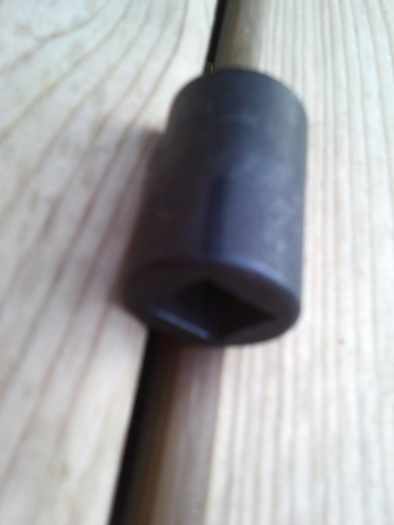

Alrighty. Question did you put new valve seals in also. First I would spay the surfaces with brake cleaner to make sure there is no grease left. Then place gaskets on block making sure they are the right way up.. Then Carefully place head on to block allowing the heads to fit properly into guides. Take head bolts and give them a shot of the lube you have on the threads. (I just dipped threads into some clean motor oil) starting from center working your way out word (make sure you use the rave manual for the tightening sequence) First place all the bolts in and in the correct sequence tighten them just to hand tight. Then repeat the sequence but now torquing them to 15ft lbs. Now same sequence again tighten the bolts with a 90 degree turn. Now final same sequence is tighten bolts with another 90 degree turn. I found using a degree wheel hard so instead what I did was marked lines on a socket. If you look at the square open end of a socket it has 4 corners. If you use a marker and mark a straight line down the side of the socket where the 4 corners are. from corner to corner would be 90 degrees if you turn the socket so from each line is a 90 degree turn when you tighten the bolt. Jut make a little mark on the head to line up with the line you just made on the socket as a starting point. now turn socket until it lines up with the next line and u have completed a 90 degree turn.About to try installing the heads again-img061.jpgAbout to try installing the heads again-img064.jpg I also suggest using a impact swivel socket for the 2 bolts closest to the firewall. When you get the heads on and all tightened up let me know then I can help you with intake gasket.
