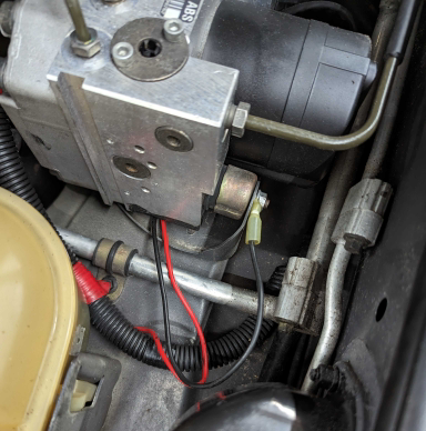

It also looks like someone did the option B fix as I found some wiring that looks like that near the abs unit.
My plan is to finish the front rebuild, clean the rears, clear the codes and see what comes back. Is there anything on that list that I should be looking to address now or are some of those codes just fallout of the system being in such a messy state?

looks like you are on the right track.
double check the ground connection and all the rewired connections on the Option B fix the OP did just in case something came loose.
