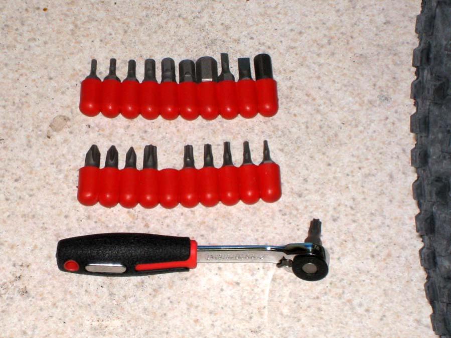

I completed the "B" mod yesterday afternoon. Was tricky getting the 4mm allen bolts out from under the svs unit but i persevered and managed to get it done.
When metering out the unit i couldn't get and results with my fluke electrical tester so i headed down to the auto repair shop to pick up a basic test meter with the low ohms (200k) setting and bingo, all good!
While down at the auto shop i picked up a great little ratchet that just accepts the small bits that come with those all in one screwdrivers. If i'd have had that when removing the bottom plate my life would have been so much easier. Anyway replacement was simple and quick with this tool. Well recommended!
One question tho is the 8 x 6mm allen bolts on the from of the unit. Is it really necessary to remove these if your just doing the "B" mod?
