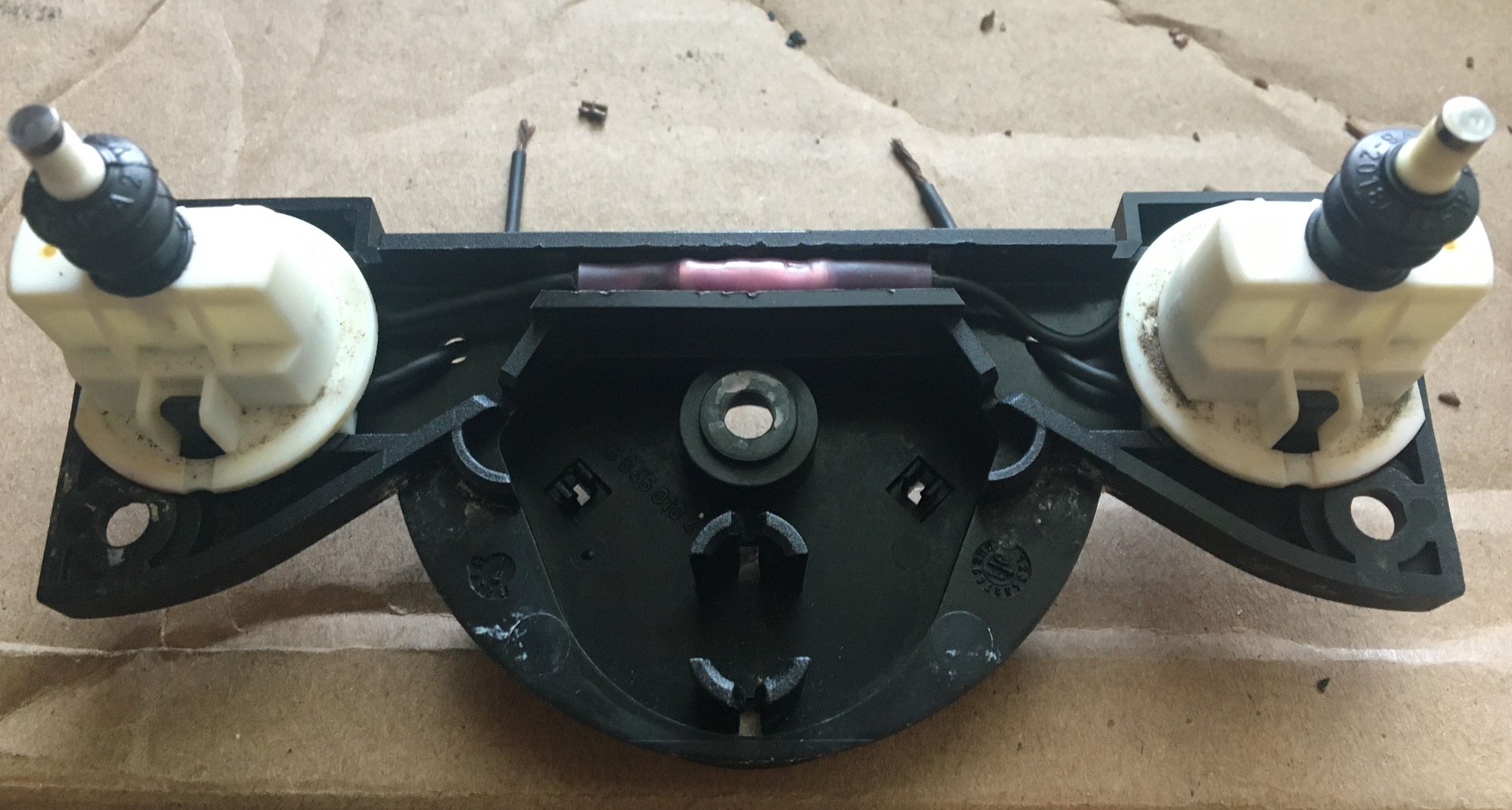

This is why Option B needs to be done! The original H1 Hummer had the same WABCO ABS Unit and they're the folks that originally came up with the fix/mod. Hard to believe but I am going to repair the above Shuttle Valve Switch assembly and then perform Option B.

To This:

Slapped in the repaired Shuttle Valve Switch this afternoon, I used 3/32 Heat shrink over the original wires, spliced the back wire back together, ran the leads out thru the existing holes, then I connected my 2 wire trailer plug to it. Grounded one wire to the AC Tie Down bolt by the PS reservoir (bolt I normally always use for this Mod), and then in about the same area I tapped into the yellow/green wire. Hopped into my friends 03 D2 and bingo no 3 Amigo's looking back at me. Used the Nanocom to verify no stored faults, tested HDC and he's good to go!
