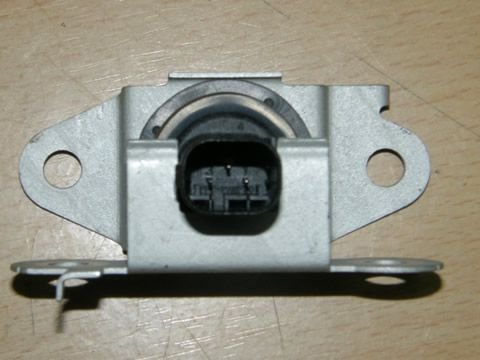

The fluid lines do get warm after a drive, that's normal. When I had my problems I changed out the fluid, replaced the filter and even bought a used valve block to swap in. I read some people's posts about having to use "textbook" software to get the system bled and really didn't want to open that can o' worms. I couldn't find parts for the system online so I ended up at the junk yard. That's where I found the sensor I needed.

Yes, when I changed the filter I didn't lose much fluid. I also changed the fluid by a method I read about here. Use a hand pump and remove all the fluid in the reservoir, fill with good fluid, run truck a bit, repeat till the fluid is clear. This avoids having to bleed the system.
All that was good for my truck, but didn't fix the problem for me. Only swapping out the sensor fixed it.

The sensor just sits in a clip - I popped mine out with a screwdriver. Replacing it took about 10 minutes.
Clip and sensor
