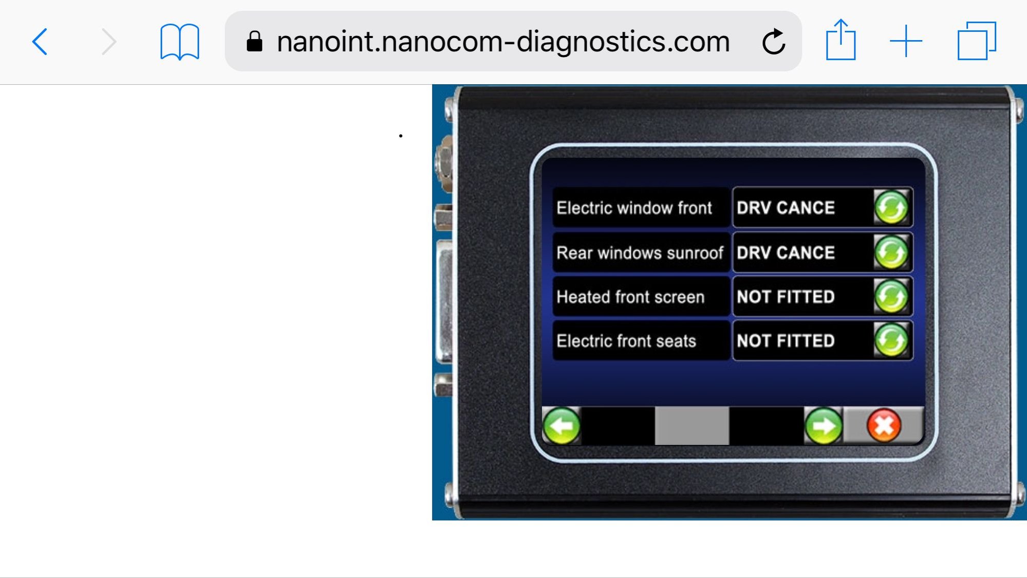

I have the hardware for the heated seats and heated windshield but neither are working. Anyone know how to use the Hawkeye total to make sure they are switched on? I poked around in the menus but couldn't find anything that seemed to match windshield or seats.
Thanks!

Its in the BCU programming ..

i know i've seen settings for activating the heated front windscreen in other devices too, so i'd say it's likely that that needs activation before it will work. i believe that it only operates under certain conditions too -- check the rave for what they might be.
the screenshot above says "electric front seats" but it does not say "heated front seats." aren't the seats manually operated on some models, and if so, couldn't that be what it's referring to?

Originally Posted by JUKE179r
Yep those toggle to fitted....Hawkeye will do that too.
