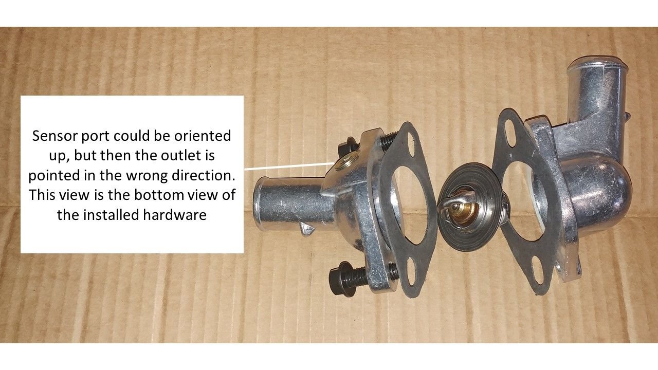

If you use a tee you can always drill and tap the threads you need over the NPT threads. Unfortunately the temp sensor port on the housing in the kit is also NPT threads, so if you have a metric thread sensor that does not help much to avoid drill and tap.

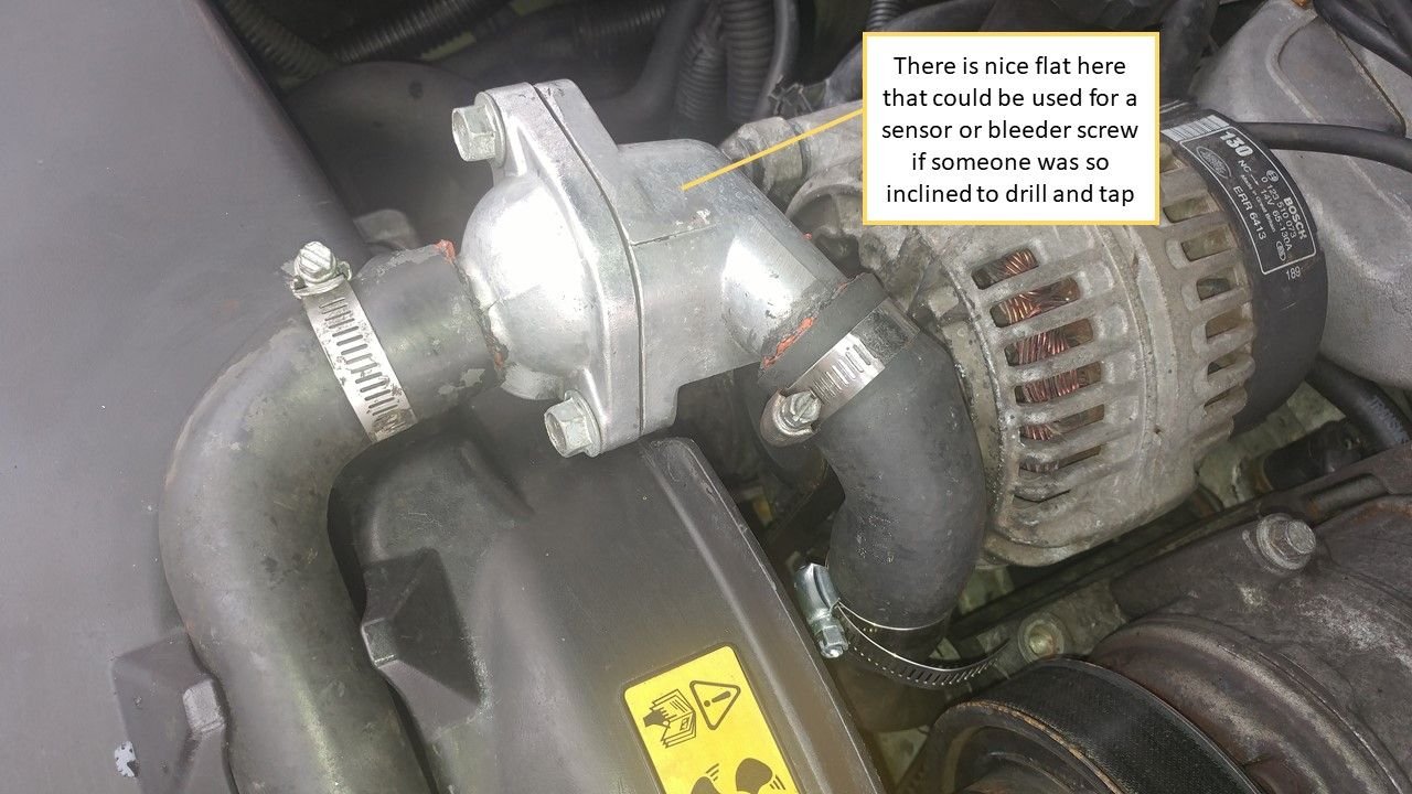

However the top of the mating housing has a nice flat on it (towards the engine and at the top of the photo) and the wall thickness is plenty thick to drill and tap, you could definitely put a sensor there.

I think having the sensor point down is probably better since it may interfere with the hood closing if it were on the top. I looked at installing in the exiting tee (or Abran's), but the sensor needs more room that is available in order for the hood to close. It's hard to tell in the picture, what's the diameter and pitch of the existing port in the housing?

Be careful drilling and tapping thin T stat housing if you have tapered thread or certain depth requirements to seat well. There is a small spare outlet port cast into some of the lower intake manifolds, maybe useful.

I screwed a Tee on a nipple in to the factory oil pressure sender port. I used a hardware store brass block tee in the TBH line, the sender was pipe threads so easy adaptation. The thread pitch on the sensor port of the inline housing is 1/4" NPT. I think the sender's with the MTX-D were 1/8" NPT, maybe 1/16", don't remember.

Well this just got infinitely easier. I'm not sure why it took me so long to come around to it, I guess I was hung up on using the old sensor. Thanks for the inspiration, Extinct. The thread in the bleed tee is 1/8-27 and VDO part 323057 is a 300° temp sender with the same thread.
As a bonus it's also a low profile design that won't interfere with the hood closing. Eureka.
