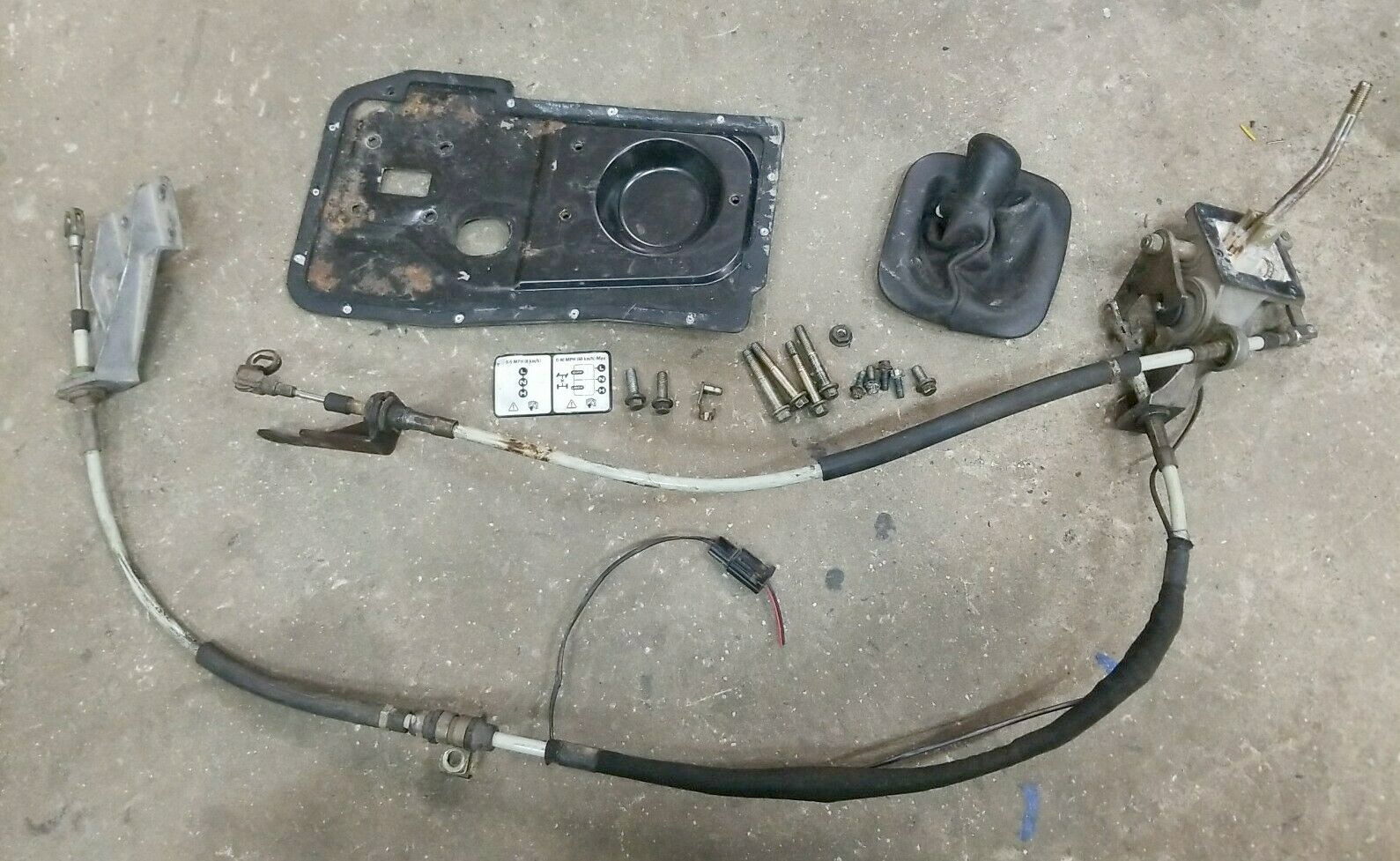

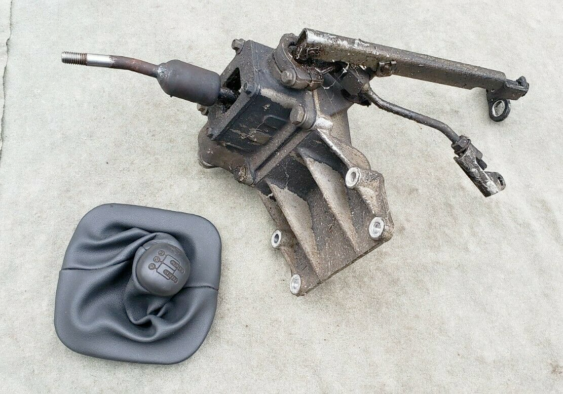

Looks like this one? Found on ebay for $150 This is a D1
Here is a 2004 Shifter set, which looks quite a bit different with the long cables and such?
Yep, that's the one. Mine was basically seized, I don't think the average driver uses the transfer case much. Cleaning, greasing, and lapping the shaft into the bearing surfaces of the end caps made it extremely smooth with no free play.

Old Dec 7, 2020 | 10:39 AM
Steve517's Avatar
Joined: Aug 2011
Posts: 120
From: Traverse City, Michigan
I opted for the junkyard route a few years ago, but held out for the 2004 linkage. I think the $300 tab that you mention is little less than I paid five or six years ago. It was a simple installation through the center console, though I had to re-do it after not cutting enough sheet metal to allow full movement of the lever. When I re-installed the second time I used quarter-inch sheet metal screws in place of the rivets and all now works as intended.
Note that the 2004 linkage includes a solenoid switch just below the lever, while the lock-out switch in the 2000 Disco is in the transfer case. If you use the 2004 unit, just remove the solenoid.
