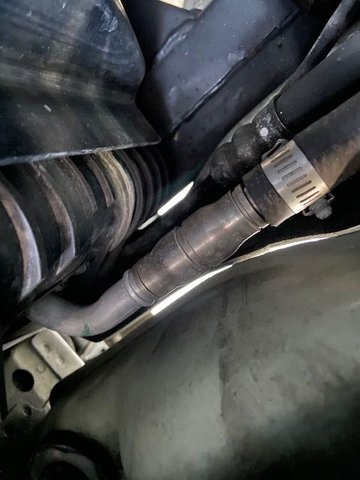

This is the PT connector. I have message in with him on availability. It's pretty slick. He has a aviation background so it might come from that industry. You still have to sand down to 14mm but it does not compress so that could be a plus with the whimpy aluminum cooler pipes.
