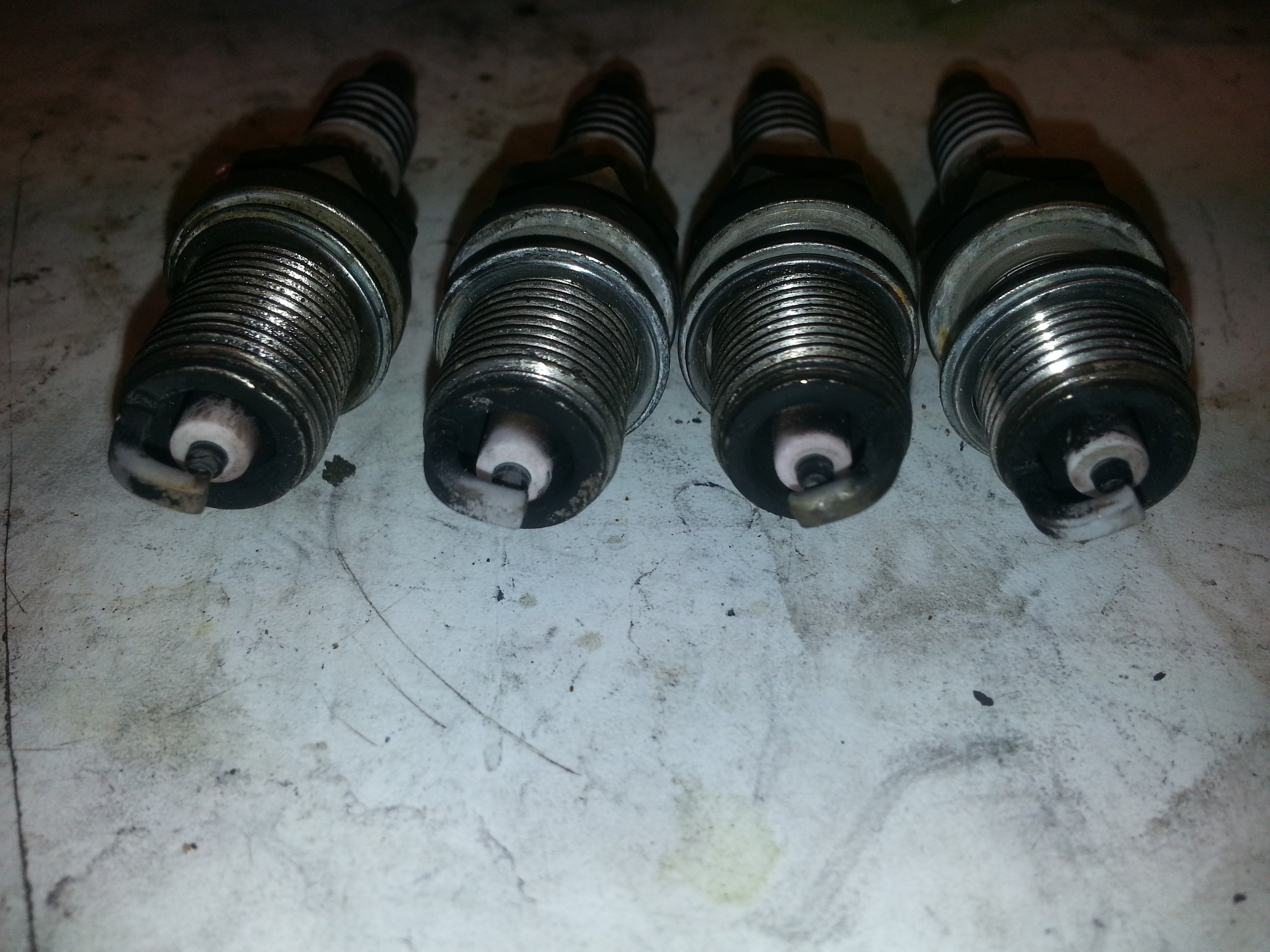

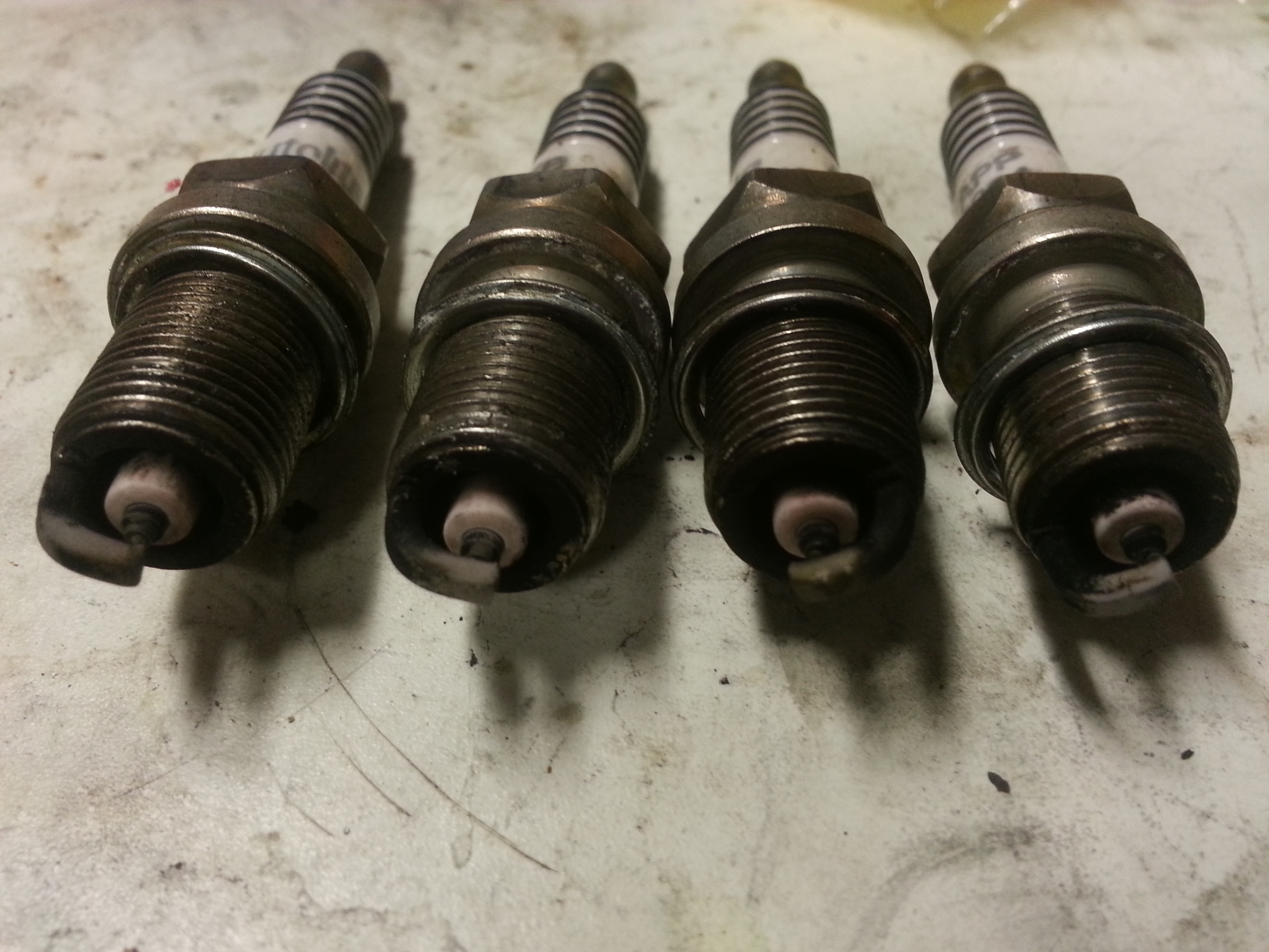

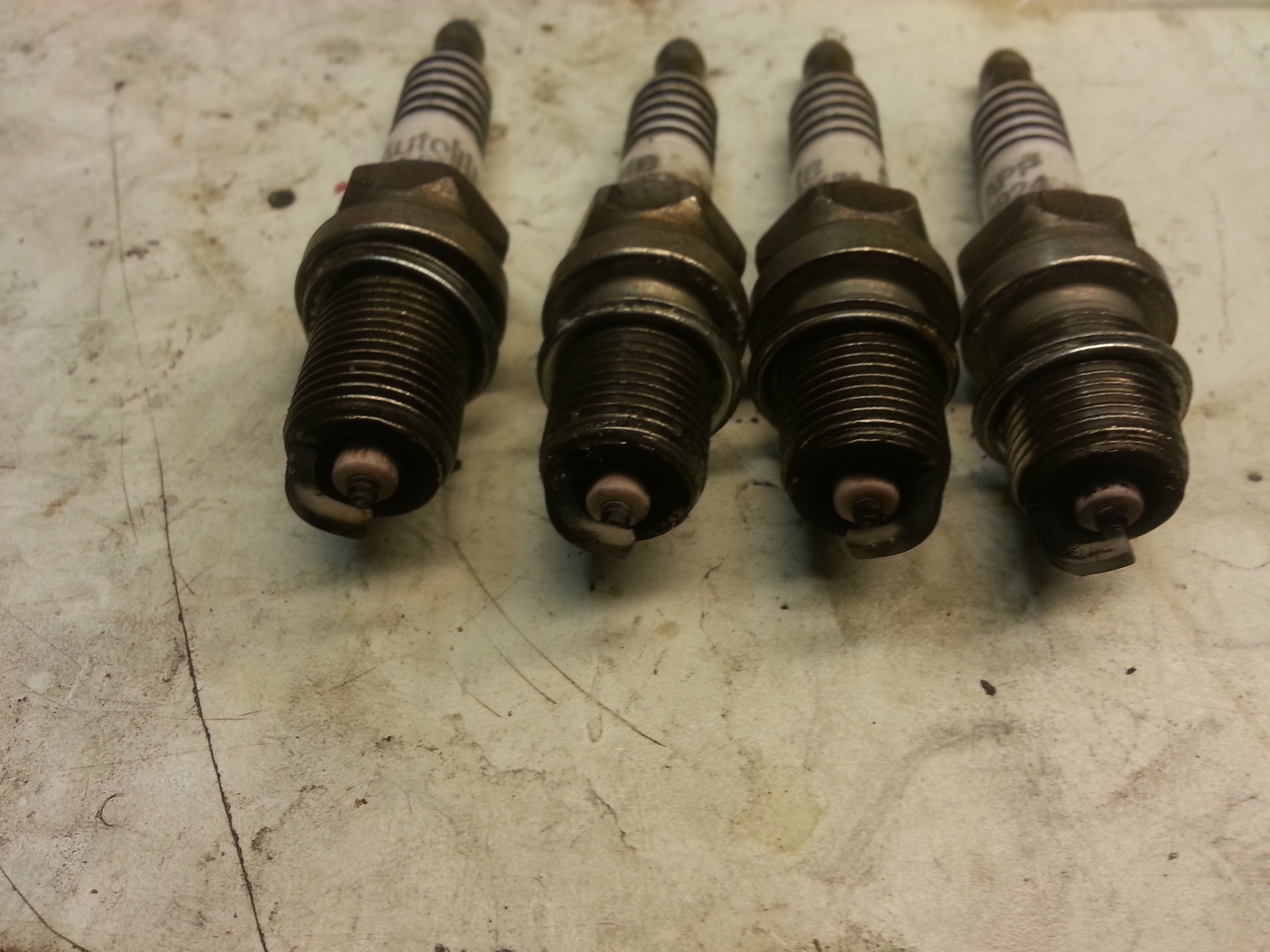

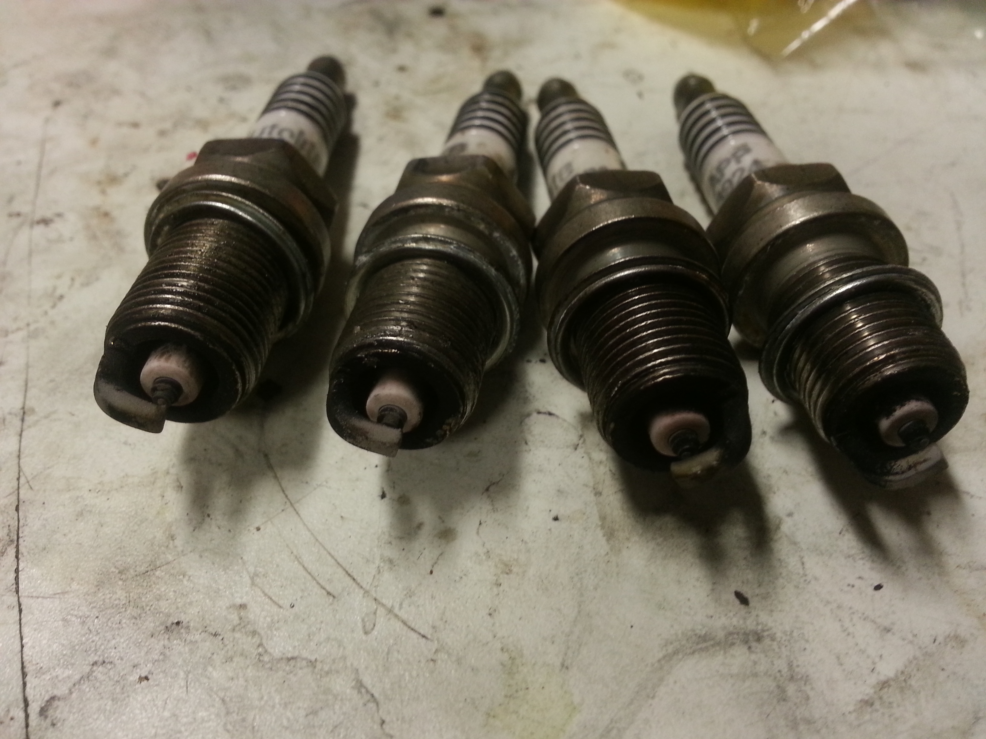

OK, thread for advanced techs. New to me 03 Disco - had a dead 02 sensor when I got in on the passenger side - drivers side cycles fine, passenger side reads zero or .1 volts.
Replaced 02 sensor. New sensor reads steady .9 volts at idle after warmup, but you can see the ecm trying to cycle it when driving - never goes below about .5 volts except on DFCO, goes to zero then. Fuel trim on that bank at -25%, Fuel trim on drivers bank around 3% positive. Inducing major vacuum leak at idle sends it right back to zero volts.
So I am thinking leaking injector or dead plug right? Pulled all four plugs, can't see any difference in them - all four white/tan electrodes
Pics attached of plugs.
I'm baffled...ideas?

The ECM doesn't cycle the rich/lean part of the sensor, the sensor makes that voltage itself. So if you have a good sensor and it's stuck rich like that, it's really running rich. The ECM only directly runs the heater circuit.
You may want to take a good look at the plug wires if they aren't new. You can run it at night and mist them with water. If there are any wires shorting out, you'll see sparks.
If this misfire ONLY happens after first startup of the day, there is a possibility that the head gasket or intake manifold gasket is leaking slowly into one or more cylinders making it misfire until it burns off the coolant. Usually with a leak like this, they are so small that you won't immediately lose a noticeable amount of coolant.
I hope it turns out to be something easy and not a head gasket!
Good luck.
