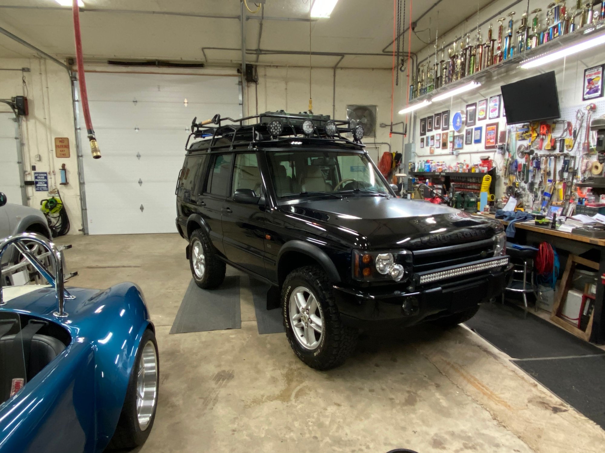

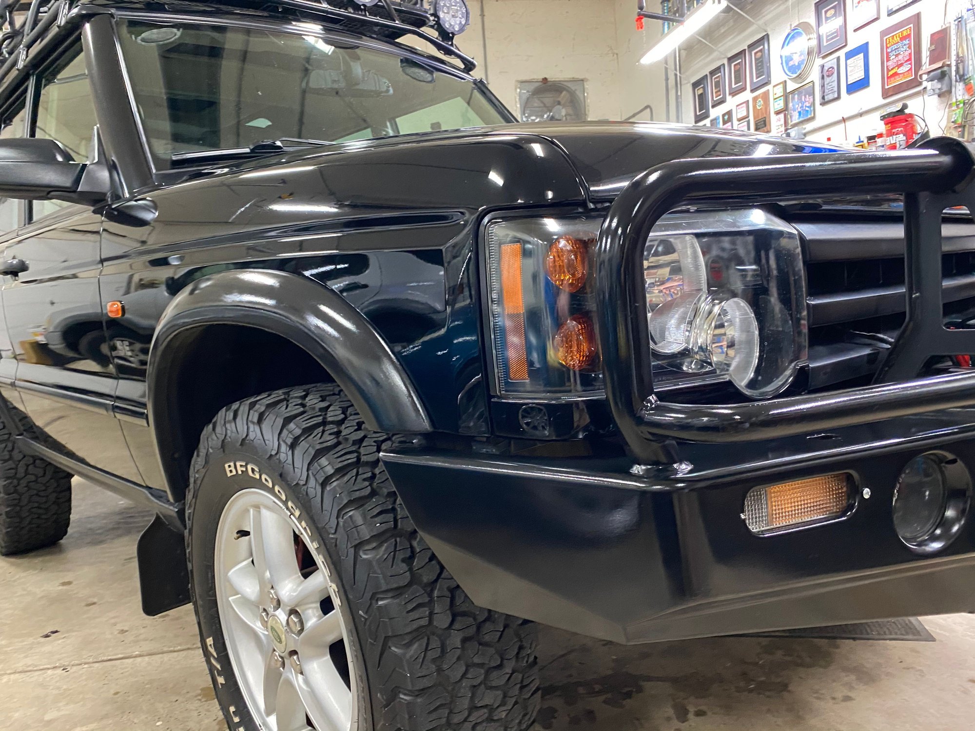

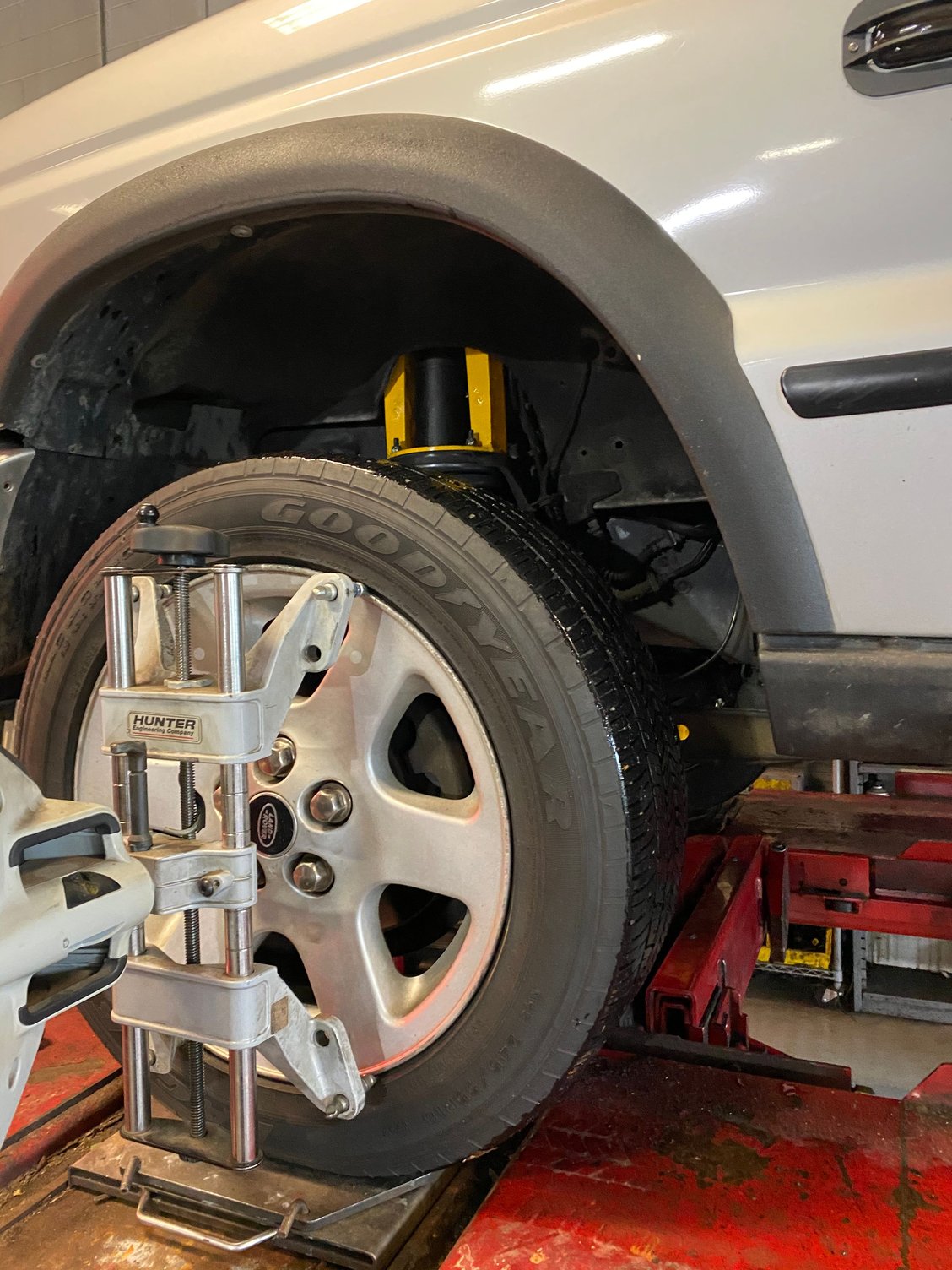

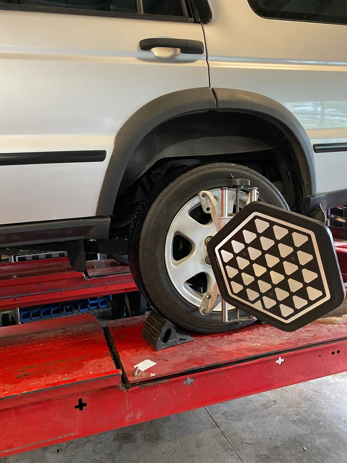

Ok, so I just installed RTE fab springs, OME shocks, and a bunch of heavy duty steering parts on my new-to-me 2003 HSE. Hopefully the pics I intend to attach will come through...
It’s obvious I have some wheel well to fill up. Looks kinda dumb at the moment, IMO. I had a 2” lift on my previous 2001 and managed to pick just the right size tires (though I don’t recall what they were, other than Goodyear). Admitted tire noob. Any suggestions or advice? I’m looking for something chiefly for looks and street driving, and as an insurance policy in the case of a Covid-19 or zombie apocalypse.
Admittedly I have not Googled for a bunch of images, though I have scanned the forum for tire recommendations with inconclusive results.
