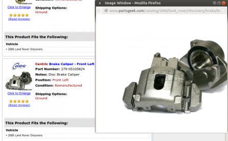

Thanks. Correct, front is dual.
Is the attached a picture goof from the vendor ?

Yes, appears to be a mistake. I haven't had any experience with Delco, all I suggest is staying away from Chinese made calipers.
