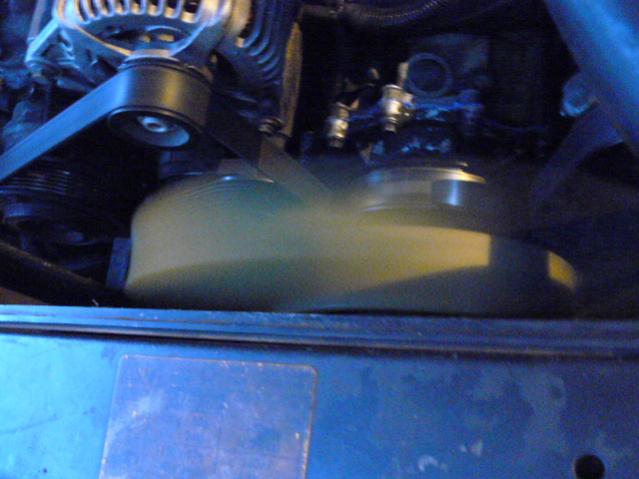

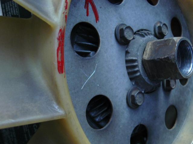

Seems like it would be easy to do, because just coolant in/out and small line to overflow bottle. Issues would be size of fan cowling to match, thickness reducing spacing from fan blades and fan clutch, and what to do with tranny cooler lines that wrap around to get to the "sub radiator".
Now, if you can't change the size of the radiator, or how thick it is, what about increasing the air flow through the stock one? Four points come to mind (a) saudi grille; (b) heavy duty fan clutch (engages with higher percentage when hot, makes more roar); (c) oversize deeper pitch fan, (d) add second electric fan on condenser, and you control temp it operates at, not depend on ECU.
Of course, most fan changes don't make much difference at 50 mph, my test ($20 of junk yard 2000 Blazer clutch and fan) seems to do 6 - 10 degrees when 100 plus outside. But my old rodded out radiator might not do exactly what your does. Bigger difference holding down heat at idle and slow moving, like rock climbing.
