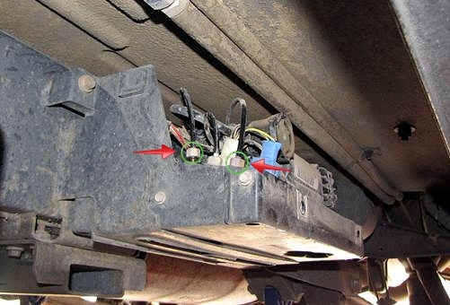

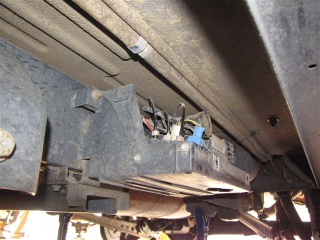

Crawl under the driver's side of the truck, right under the driver's door, with a big flat head screwdriver and a 10mm wrench. You'll see a black plastic box. Use the screwdriver to undo the two fasteners and remove the cover.
At the front of the compressor assembly (the part closest to the front) you should see three black air lines going into a block that are held on by brass fittings. It should look like this:
What you want to do is use the 10mm to loosen, but not remove, the two outside fittings.
If you take them out, it will be a bugger to get them back into place and they may not seal. Leave the middle fitting alone. Just loosen the left and right fittings. You'll hear the air start to hiss out and eventually the air springs will depressurize.
