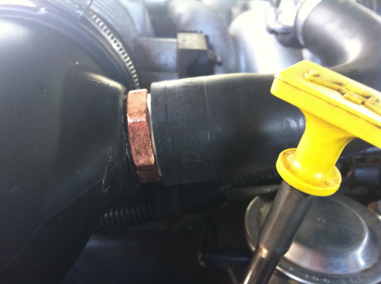

Here are some pics of both the piece and the install, I clamped it but these are without the clamp. The 3/4" was definitely tight but the plastic that I was inserting it into is very flexible and rubbery, so I essentially just screwed it in, then did a clear latex silicone around the outside, (also after the pics).
Let me know what you think.

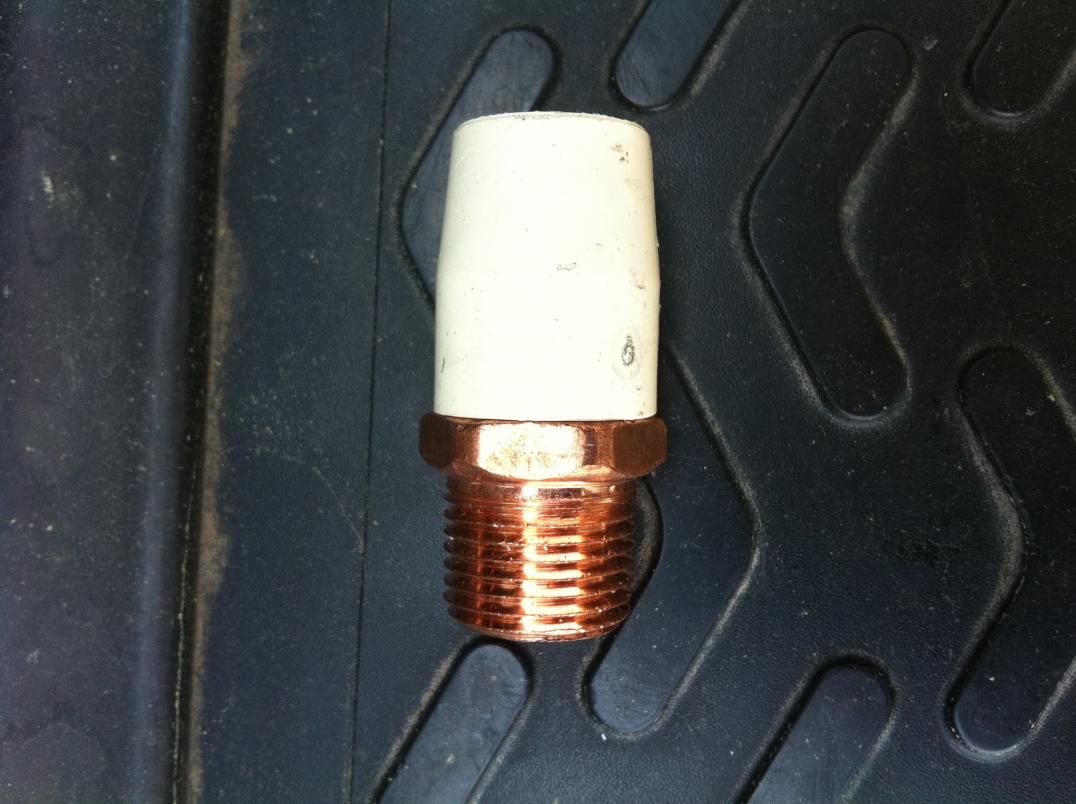

Default The actual Piece
Sorry, did not take the pic of the piece prior to install, please find attached.
