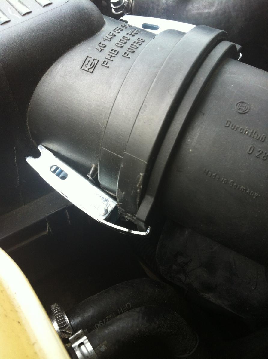

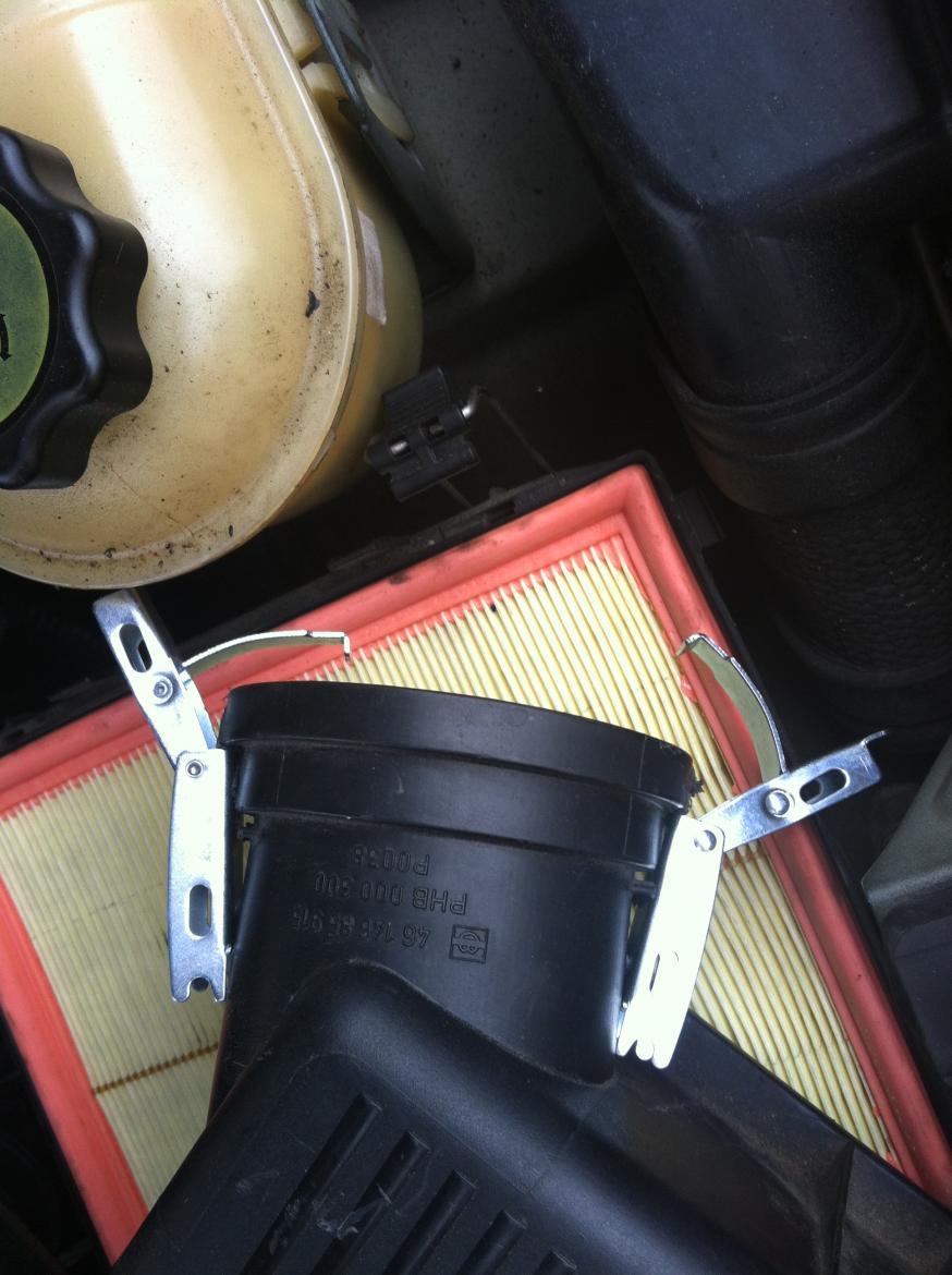

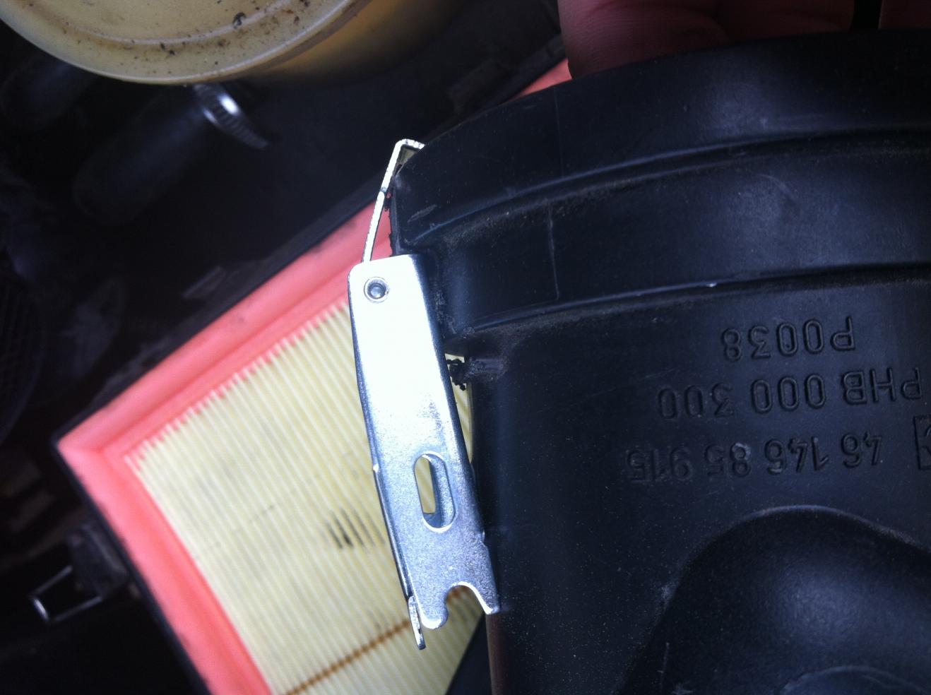

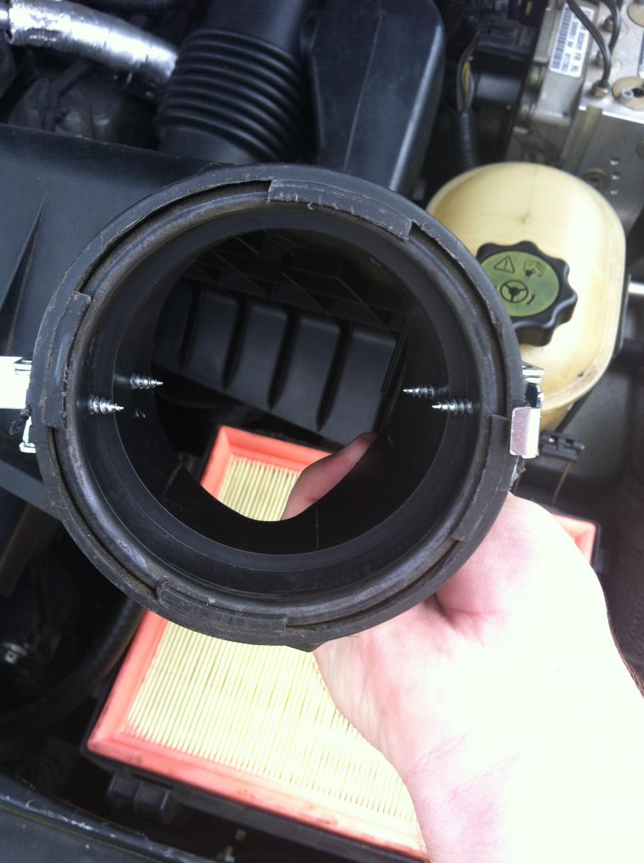

Just thought I would post my lid fix for anyone else looking for a cheaper alternative then buying a new lid. I used my dremel to shave off the broken plastic clip holders, pre-drilled my holes, and used the screws that came with the draw hasp to attach it. The screws will go through the tube and stick out but they don't touch anything, so I didn't feel the need (was too lazy) to cut them off. Works just fine and has a tight seal. Hope this helps.

Update... did this yesterday.. took about 25 mins... start to finish... that inlcuded using visegrips to get the damn security torx screws off the MAF.

Why did you have to remove the torx scews?

Considering I save $95+ for a new air box, worked out GREAT!
