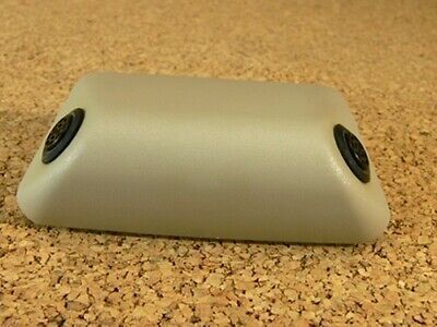

oh didn’t even think about that. That honestly might make more sense. Where is it?

It's on the headliner in the rear if your truck is so equipped. My truck had it, but my wife's truck does not. Looks like this:

Ah OK I've seen that in junkyard discos but I don't have that on ours.
