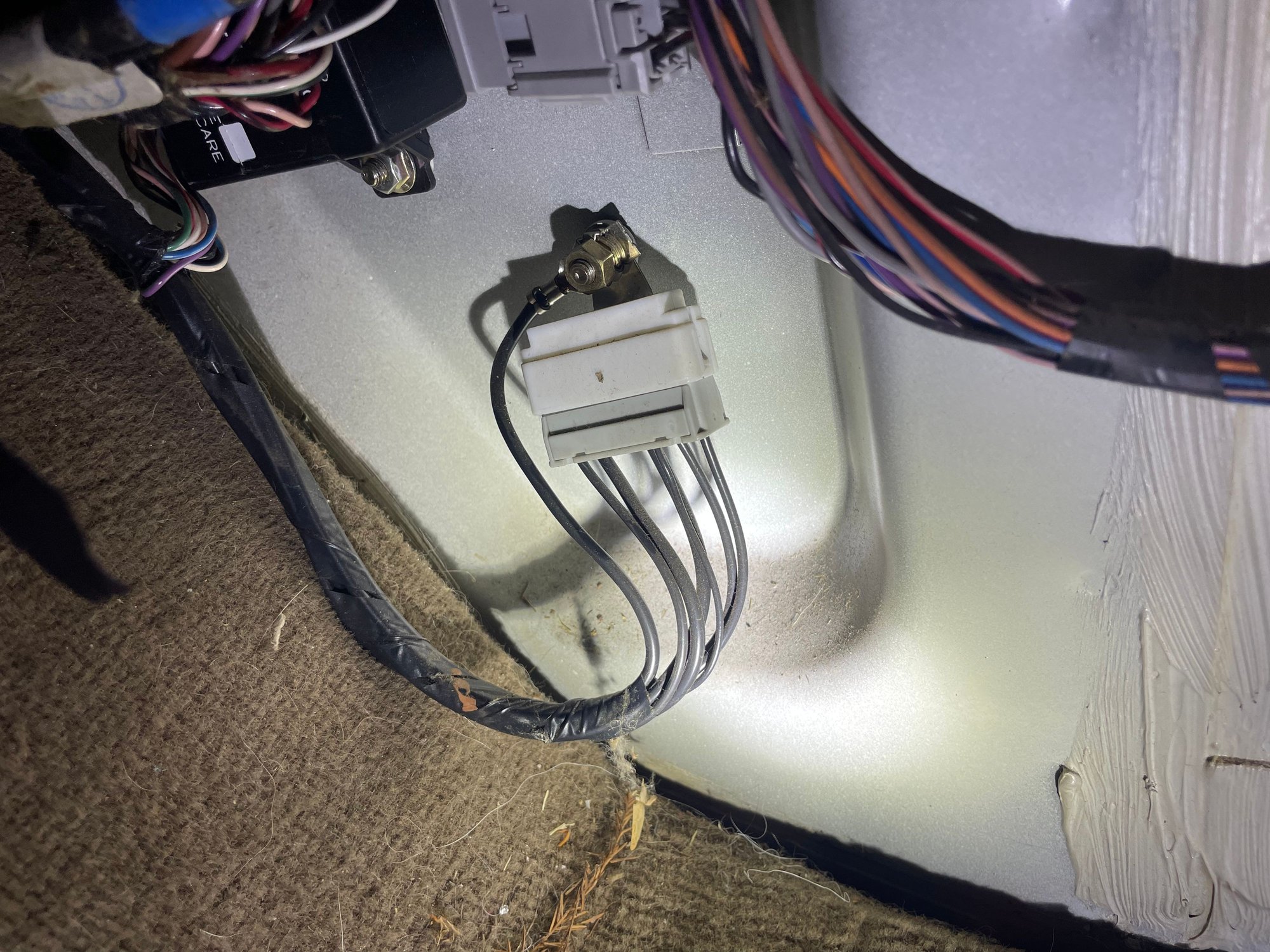

any ideas what could be causing this? I have thought bad ground possibly and checked the interior connections behind the panel near the passengers feet. It looks clean but I am unsure if the single wire connected directly to the bolt is stock or if the previous owner added/re-routed something. (His work was not great to say the least)

the picture is the ground connections I am referring to.
