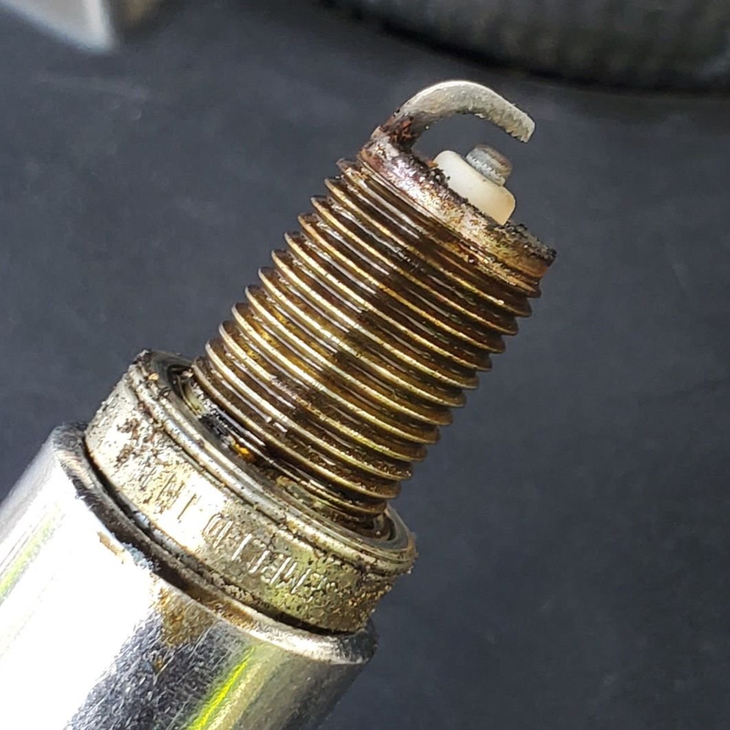

As per your suggestion, I started by swapping #5 plug with #6 ...plug pulled from #5 looks pretty nasty compared to the one pulled from #6 (see pics attached). ​
Pulled from #5
Pulled from #6
Cleared all codes before driving away and immediately SES light starts flashing and occasionally keeps steady. P0305 code immediately appears as a LOGGED fault, as well as a PENDING fault, along with P0300. Although is running much better after oil change, I can still feel a soft rough idling, and can also hear like a soft "puffing/hissing" sound that accelerates when given gas, you can listen to it in file attached. I have not heard the rattling noise that used to come from CAT.
Please advise if now I need to swap wires, or if I should give it a couple days.
Thanks.

Your P0305 indicates that swapping the plugs didn’t solve the problem. Next try swapping ignition wires (it’s not easy to get at the coil end of the wire, there are lots of threads on this forum about how to change ignition wires).
