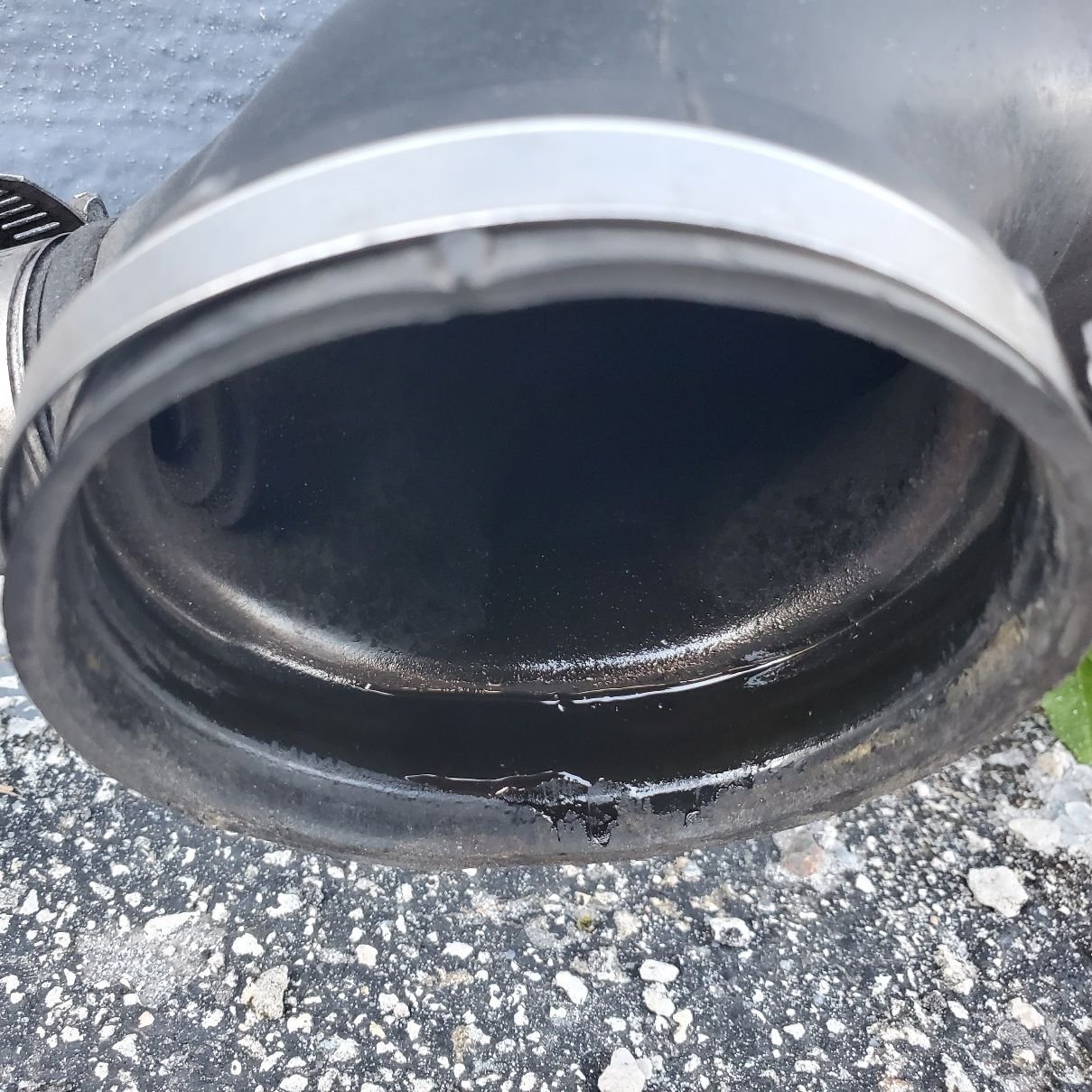

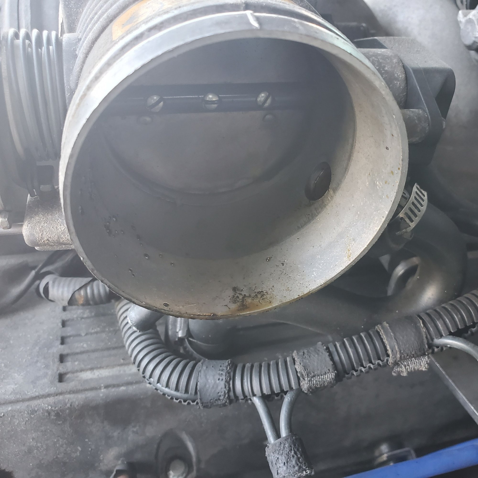

So took the time this morning to finally do the wire swap and keep troubleshooting. Decided to follow the long-proven method of removing the upper intake. After removing it, I saw that upper side of gasket, and lower face of intake pretty wet, and I do not recall seeing them wet in previous removals, just not sure if this is normal or a sign of some other issue. See pics attached at the bottom of write up. I also found that coil pack plate was left unbolted, so it was free to move a bit within that space. I checked all wire plugs in case any was loose, but no; so, went on to swap cyl 5 wire with a used one I had -it came from a new set with very low mileage that was replaced back in OCT-NOV 2021, but I'm pretty sure it is OK. Put everything back together, secured coil pack plate with the 2 lower bolts to ensure it did not move; wiped clean the upper face of intake gasket and lower face on upper intake, bolted and connected everything, including battery that I had disconnected. Fired up the Disco and it started with no issues; it started right up nicely. Codes had been cleared when battery was disconnected, so did not do it again. Stayed put with Disco running while I gathered all tools to put away; Disco still pretty stable; no solid or flashing SES light, so decided to drive around for a bit; I did feel it a bit rough and shaky, perhaps not as much as before, and a block or 2 later SES light started flashing and stayed solid, in fact, it stayed more solid this time around than pre-wire swap, but it still flashed at times. Check the codes and P0305 was LOGGED again, as well as PENDING, along with P0300, but I will not care for pending codes, just the "LOGGED" one (P0305). So, after swapping cyl 5 plug with cyl 6's and replacing cyl 5 wire the issue still persists -P0305 code present, a bit rough and shaky, especially when giving it gas. I will not be driving it anymore today, but tomorrow I'll clear the codes again and will take it for a longer drive to see how it behaves, but I'm guessing P0305 will light up again. Please advise where I should look into next to keep troubleshooting.
Besides the pics at the bottom, I'm adding a couple videos: one right after removing the upper intake so you all can see the state it was in, the other after firing it up after putting everything back together, let me know what you guys make of the noises you'll hear, take a look at crack on sleeve near nuts of throttle wire, how wet steering box looks, the way fan wobbles since it has a couple broken pieces and battle scars, and anything else you may kind enough lay your eyes on! ;-]#

See the small puddle on inner lower lip.
See how wet it is on inner lower lip.
See how wet it is around the intake holes.
See how wet it is the upper face of the gasket, and how dirty the 4 closest intakes to the front.

Do you have pcv mod done? That might explain oil in intake if not. As far as troubleshooting, now swap left coil with right coil.

Take that PCV hose off valve cover and check to make sure baffle is not in there, then take off opposite end and see what is under the hose, post pics or compare with best4x4
