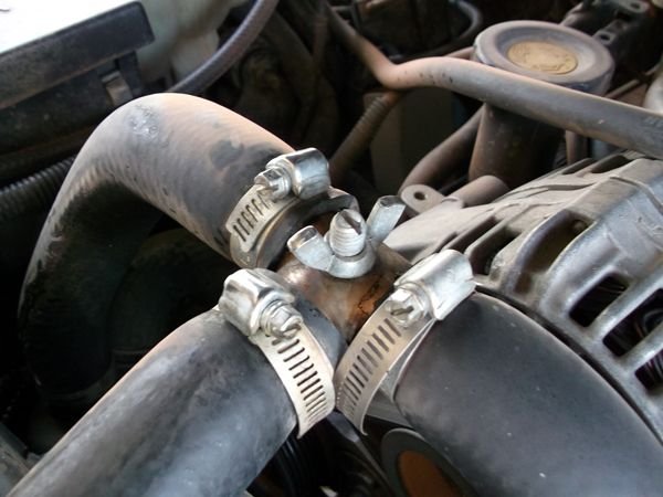

Here's a quick photo
T fitting fix
The head of the bolt - on the inside, has a rubber washer. I cut the slit in the top of the bolt so I could keep it from turning when tightening the butterfly bolt.

Nice solution!

pretty neat!

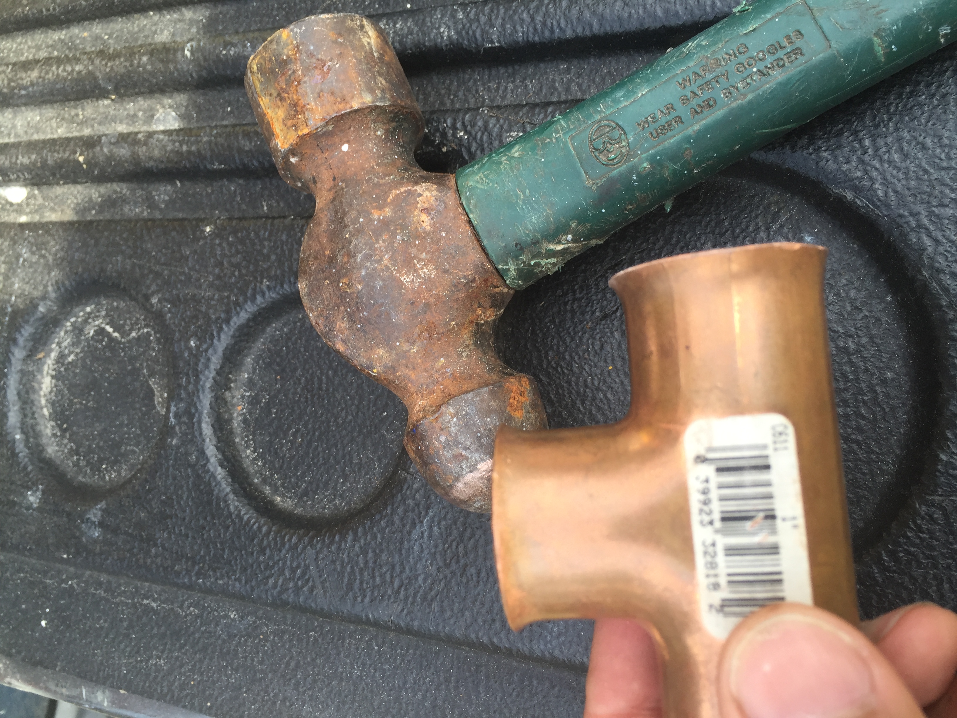

went to lowes and got the T.... but no bleeder . not sure about the cons of no bleeder?

"made a small flare"

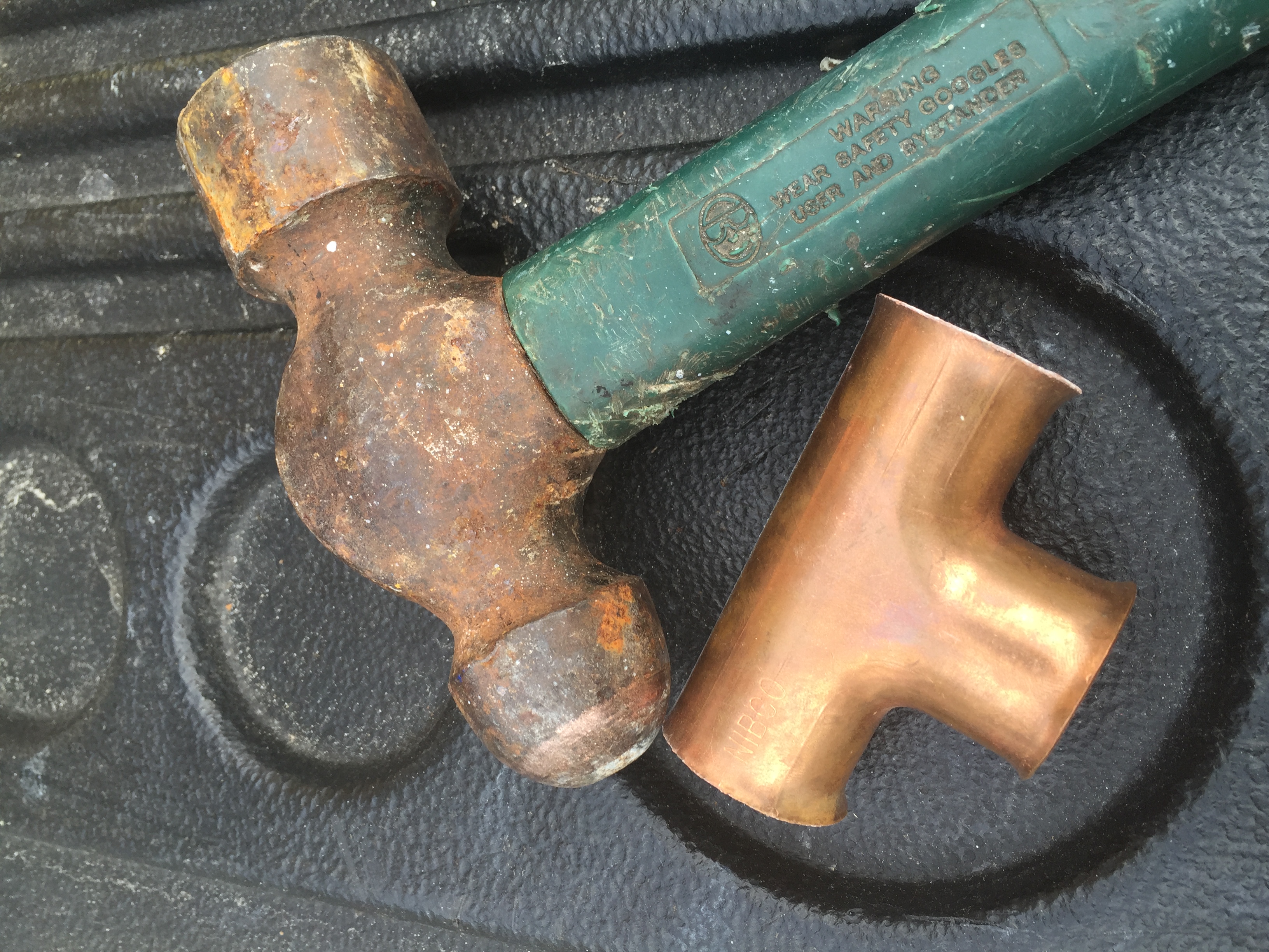

Old May 4, 2016 | 06:59 AM
RawFaith's Avatar
Joined: Jan 2016
Posts: 302
and a temporary solution since it was Sunday !

I like that alot.
The only con of no bleeder is getting air out when you change the coolant, or if you wanted to put a sensor in the bleeder thread. But the air will work its way to the expansion tank and, honestly, how often do we have to change the coolant...
