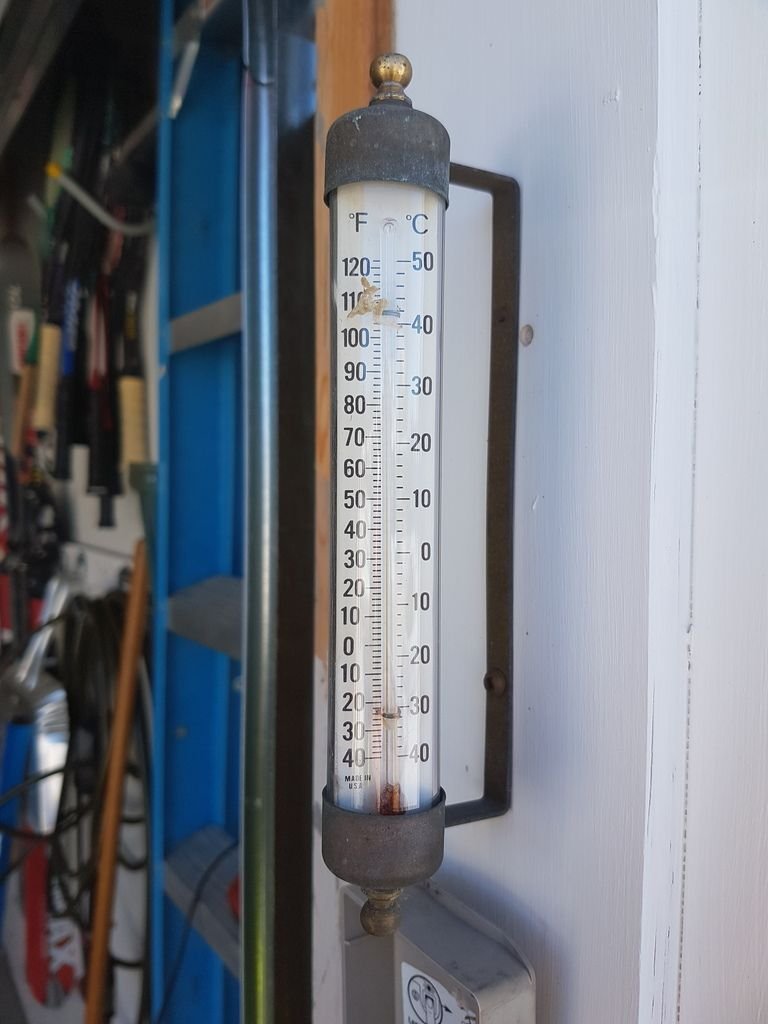

Well now it won't keep air in the driver side bag, once the compressor turns off it empties in 2 minutes. It being -40 probably doesn't help. I'm stumped. It holds air after being parked for 3 days , but is on bumps when I go to the bank for 5 minutes and holds air again over night.

Originally Posted by OffroadFrance
and spray the suspension bags with soapy water.
Inside a well heated garage......
