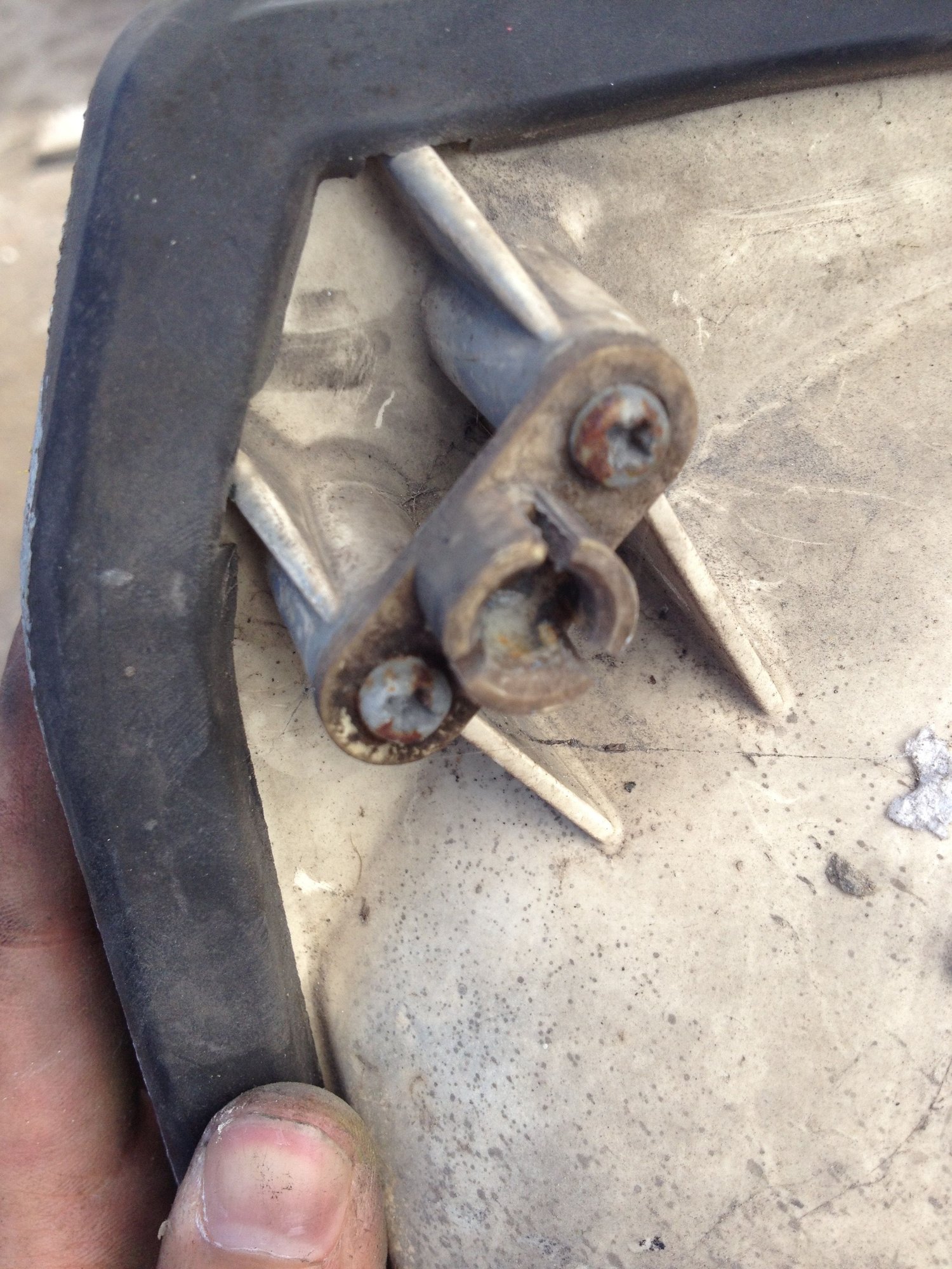

1) Visibly no scratches or cracks
2) Passenger side headlight has water
3) Connections are *bad* (I guess???) - the headlights just popped out, I didn't even unscrew anything.
4) They would cost me ~$80 for both to obtain

One of those lights looks fine, but the one with moisture in it is a no go. Also 80.00 for the pair is 30.00 to much. They shouldn't be more than 25.00 each. The only thing I'd grab off of those D1/D2 lights is the rubber ring that helps keep crap out.
When getting junk yard LR parts you gotta know exactly what you looking for or you can just be tossing $$$ out the window.
Hobby wise you honestly can find better vehicles to grab stuff off of that you can sell to mulitple car makers like GMC, Chevy, Cadillac where the parts span across several different models making it quicker/easier to sell. LR wise people use Will, Abran, or Paul for their used LR needs where they're in the business of parting LR's for years and have excellent quality/tested parts.
Not here to burst your bubble, but just trying to save ya $$$$ in the long run. I grab parts for friends, or fixing up friends LR's, but I'm not gonna go make a career out of it.

I said it in a previous thread, if you are willing to do the work those headlights can be fixed. Look up how to bake a headlight, you will probably find the steps on the Subaru forums.
In a nutshell, warm the oven up (don't recall exact temp but, I believe it is 175).
Pop the headlight in for 10 to 15 minutes, get (2) flathead screwdrivers
When the bonding agent is hot enough, pop out the lenses and clean it up. Repeat the baking process to put back together.

Moisture will remove the silver reflective paint/coating on the light. Thats the big issue. Even if you remove the moisture (easy to do without tearing it apart) you'll have a light with horrible light output.
