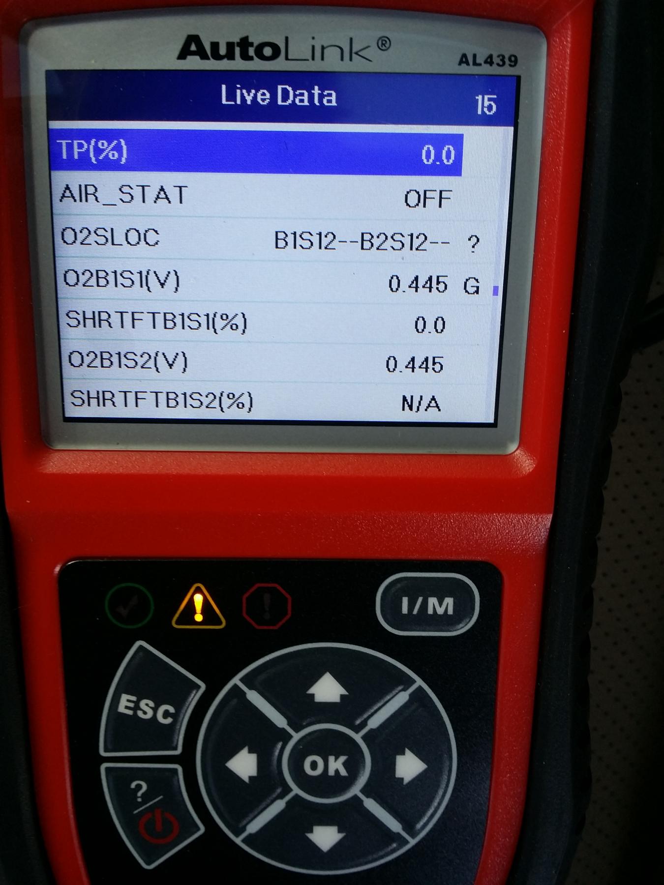

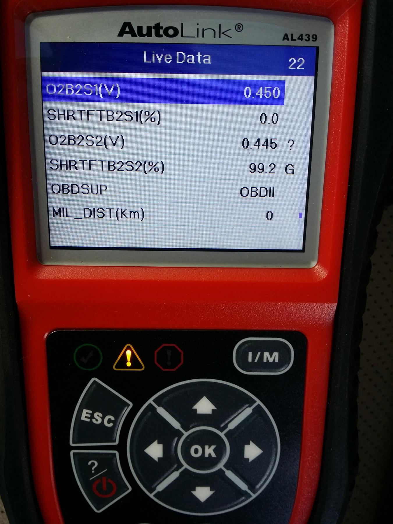

03 Discovery 80,000 miles. 4.6 lt, Mint condition. However havn't heard it run. Doesn't have any spark, looked hard and don't see anywhere to check if the fuel rail has fuel or not? I did get ahead of myself and installed a New Fuel Pump. Doesn't even fire, turns over fine though.
I did fool with the shut off switch on Passenger side on firewall, no difference.
So what Im hoping is that someone can guide me of what is the right thing to do next? Im not familiar with the OBD testers, so hoping what I've posted will be clear to others who do know!
thanks in advance.

You need to read the actual trouble codes, not just the live data. They will look like "P-0xxx" with the xxx being numbers. like P0302 means misfire on 2.
Once you have these codes, google or search on here.

Check the "RPM" data stream on the scanner while you are cranking it. If it reads zero you most likely need a new crankshaft position sensor.
x1 all of those photos are just live data info. You need to run defect codes, clear them all, re-run the truck and then see whether they re-appear. Then post the codes here on the forum for someone to assist.

thanks guys, I'll fool around some more, the OBD displayed "no codes found" so that was very puzzling. But I'll try again.
I've read about others having issues with their Crank Positioning Sensor. So I jacked it up , crawled underneath and didn't see where it is? I saw one video that showed it by the R motormount, then in a manual, was saying its by or around the torquenverter cover. Didn't see it, so may not have been looking in the proper manual ?
Will try again, and will look into ordering the CPS
thanks
