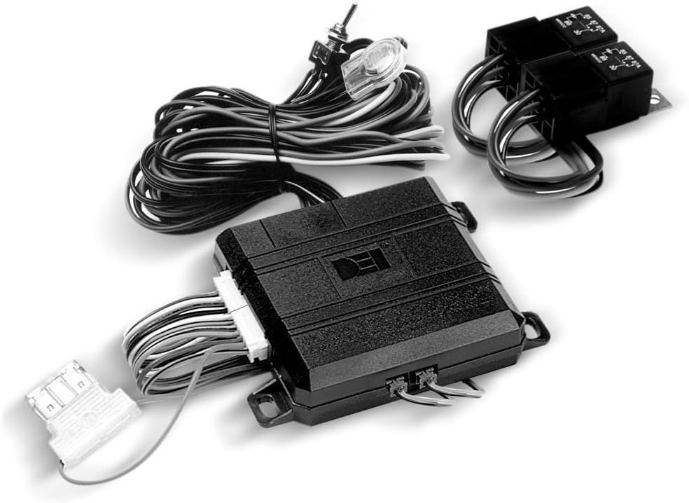

Maybe install something like this:
Amazon Amazon
Directed Electronics 545T Nite-Lite System D
  • Automatically activates headlight and parking lights when driving in the dark
  • Turns lights on when windshield wipers are in use
  • Adjustable turn-off delay
  • Includes photocell, relays and bypass switch
  • "Nite Lite" System
Of course if you do, document it for the rest of us
Good Luck!
