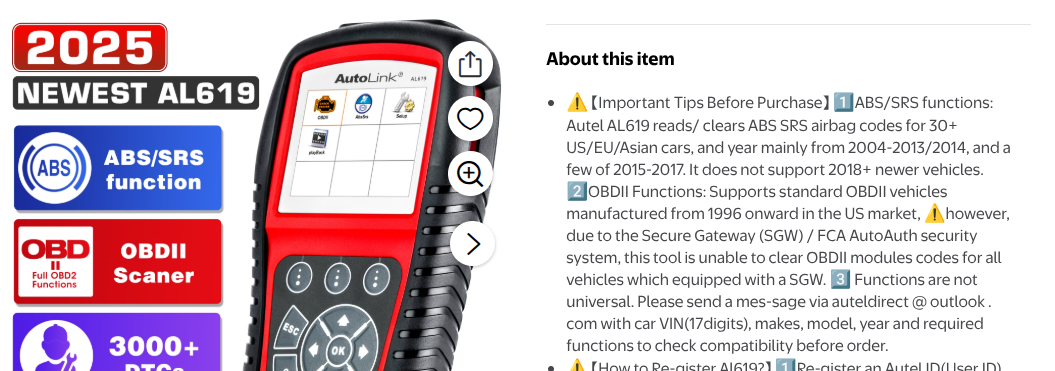

Hi.
Planning to buy a scanner to use on 2000 and 2003 Discoverys for OBD2 and ABS. Thought it was the working one but saw this:
----> Avoid or buy ?

Bullet 1 tells me that it will not do ABS. Did you send your VIN to them as they suggest? I presume budget is the reason for this instead of a Nanocom? Remember the the most expensive tool you can buy is the cheapest one you find.

My scanner died and remember from older posts too, the AL619 behaved well for many members owners of Disco2 . Now saw the manufacturer posts being for after 2004.
