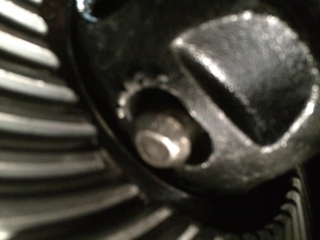

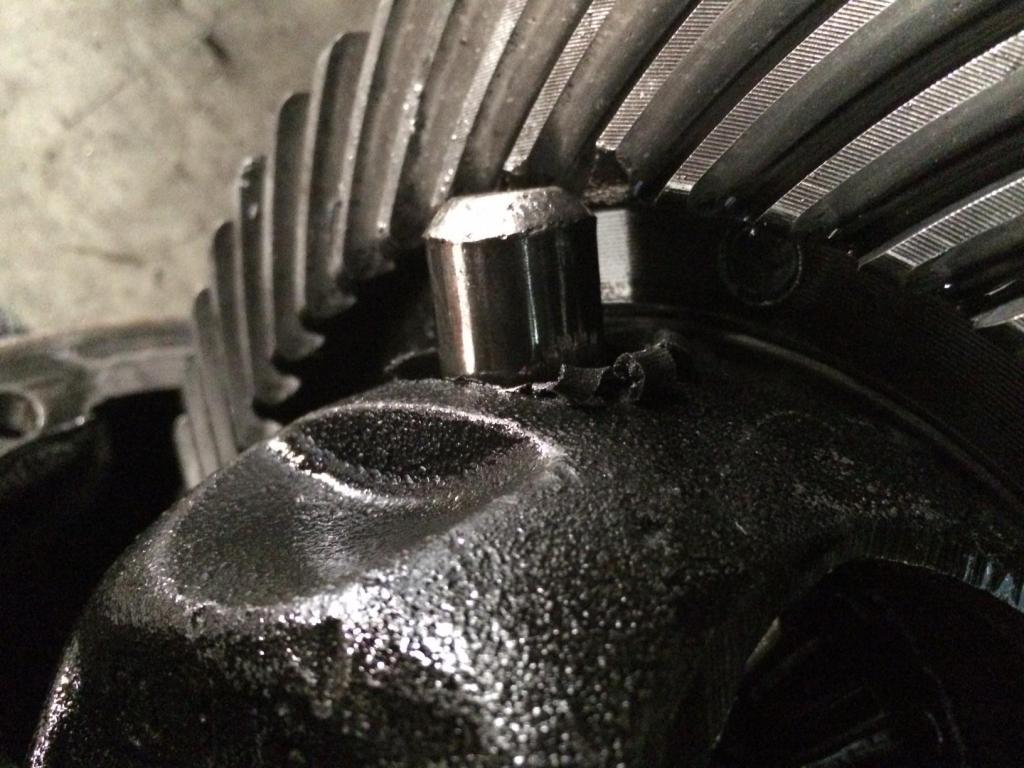

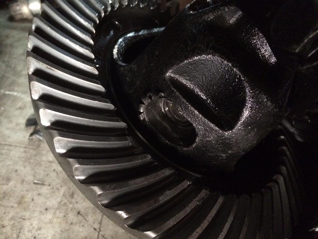

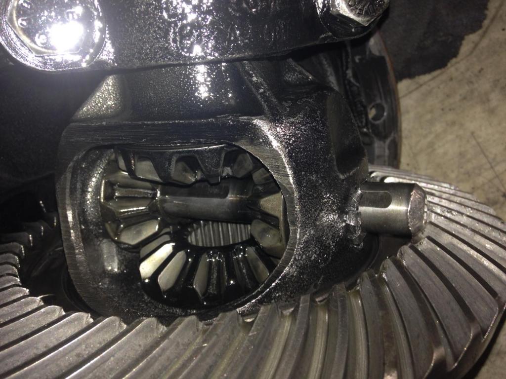

So, loose center pin on the front dif hitting gears and causing havoc!

That looks a rather nasty mess Abran. It appears that the planet gear pinion has either overheated, seized or run without oil at some point and slotted it's location hole where it's pressed in as an interference fit. I can't say I've ever seen anything like that before. It looks like a new diff is required. I would send the photos to LR asking WTF (not that they seem to give a FF these days). That shouldn't happen even with 500K miles on that diff if it's been serviced normally. I have never seen anything like that before it could be just bad engineering. It might be worth sending the photos to Ashcroft and asking them have they experienced the same problem in the past.
PS. It might be worth asking the US vendors, AB, RN etc whether they have seen anything like that before and find out why?.

Bought the car from a nice guy who had overheated the motor resulting in a slipped liner. Turns out he did not maintain it too well as the second owner.
The diff oil was quite thin, almost like water with a lot of metal in it. Pulled both axles and cleaned the tube out as best I could, then replaced the dif with a good use one.
While at it I changed the rotors and pads.
And just before this I started noticing a lifter noise. The hits keep coming...
