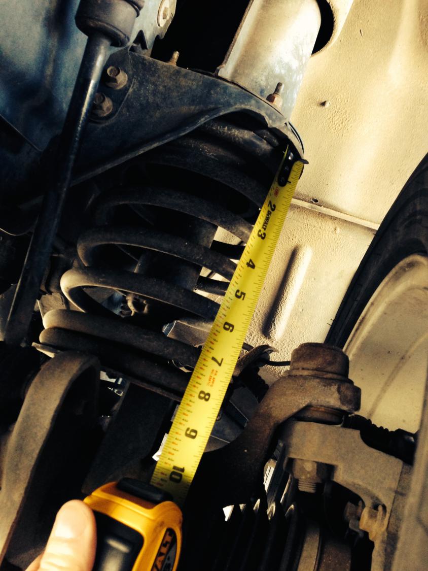

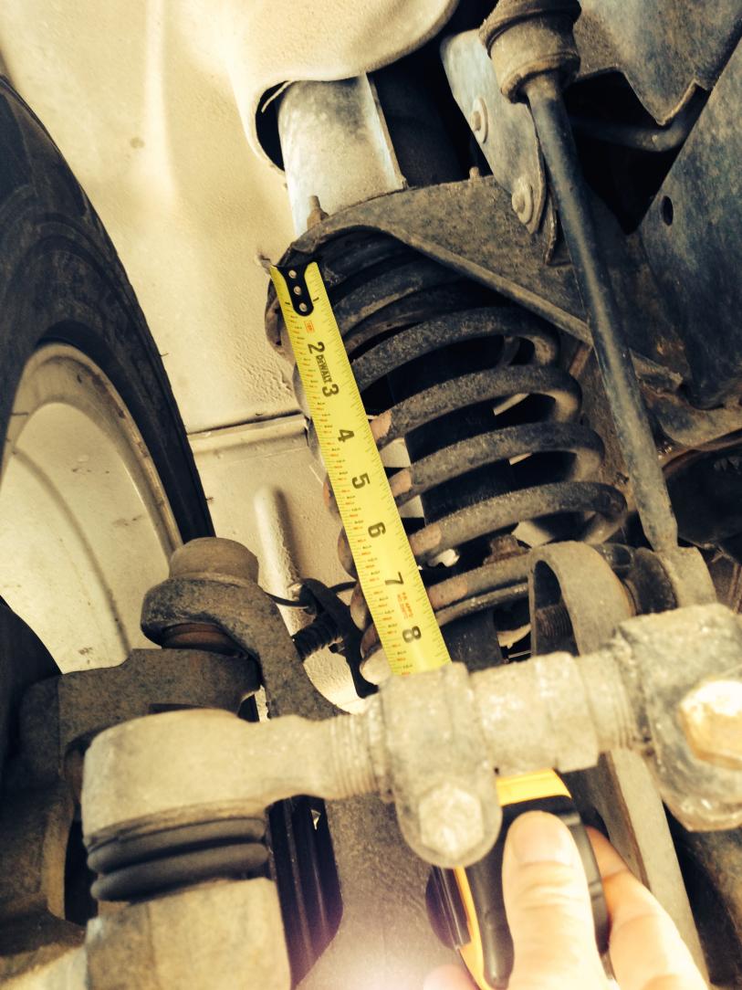

I lifted and put the truck onto jack stands...planning on putting some new tires on and want to ensure the suspension is all tight and ready for alignment. ( It has been pulling to the drivers side pretty good and wearing the inside of the tires). Everything tested nice and tight. I have also been feeling the bumps big time. ( I know the worn out 18" tires will be contributing to this) I have had Big O and Discount do alignments in the past and have not been able to correct this "pull"...alignment aways within specks.
The one thing I noticed yesterday was a difference in the spring height as they sit compressed. Would like to assume this means they are pretty shot and due for new ones? Passenger side is just shy of 8 inches....Drivers side was close to about 8.5 inches. Is this a fair assumption? See Pics.

It is also reflected in the measurement from the ground to bottom of wheel arch.

yeah prolly worn, but shocks worn is a bigger contributor to hard bump crossings. drivers side is supposed to be taller, so no surprise there.

The measurement you want is from the center of the wheel to the bottom of the wheel arch. This will let you know, independent of tire size, how much your suspension is sagging.
Are those original springs? how old are the shocks?
Before you spend any money on alignment or other suspension issues, you should get the basics sorted out, new shocks and new springs preferably at the same time.
New springs will be marked so you put the taller one one the drivers side.

I have found that putting any shocks on warn sagging springs will shorten the life of the shocks. I had a set of Bilsteins go bad in six months this way, they still spring back but the ride was not at all like when they were new.
I put new springs on and the Bilsteins felt even worse!
So new springs with old shocks is not a good idea either as the existing shocks were compressing about 2" higher than they used to. Felt every pebble on the road and potholes were still jarring.
The only way to go is new springs, new shocks, same time.
