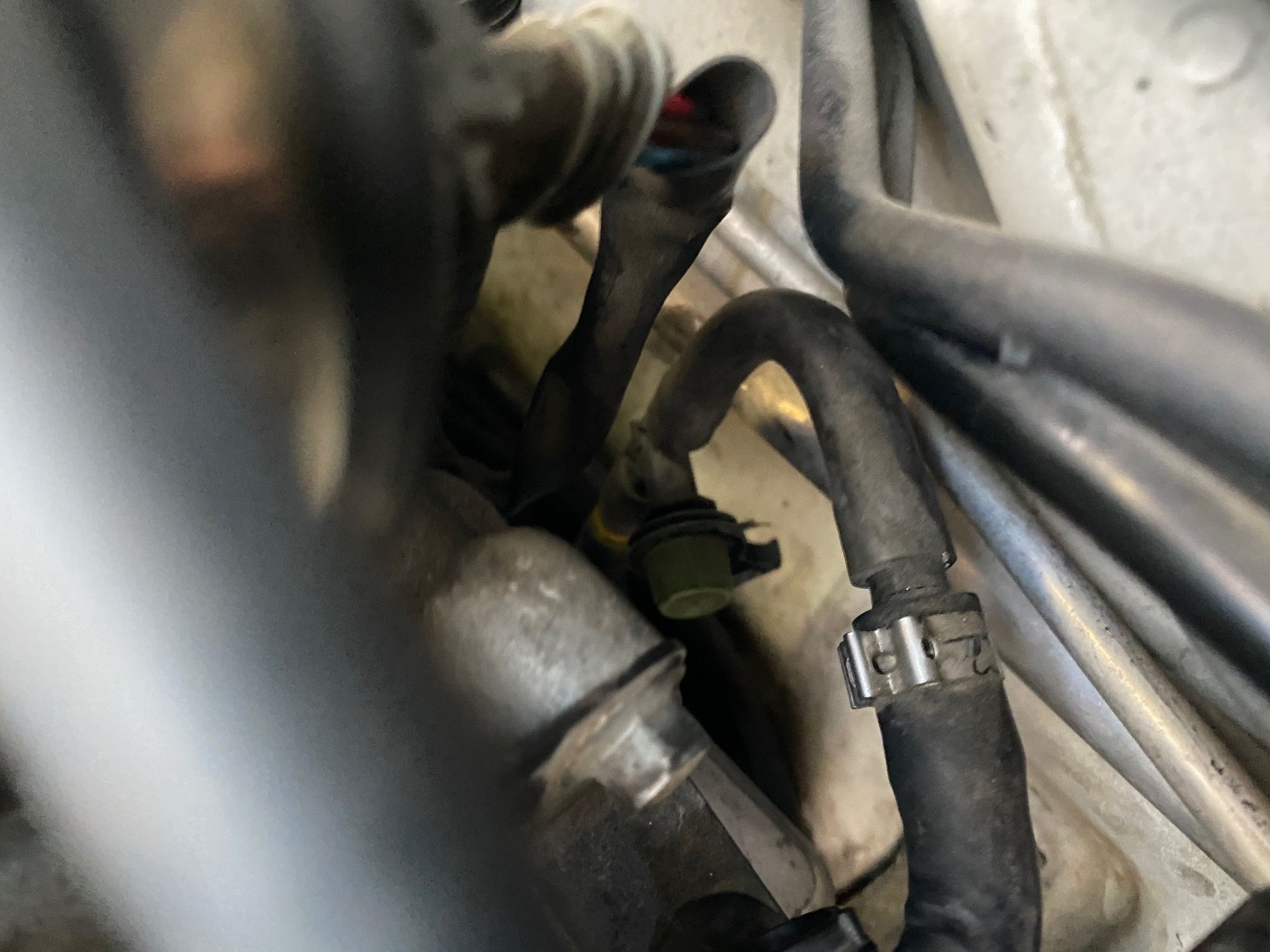

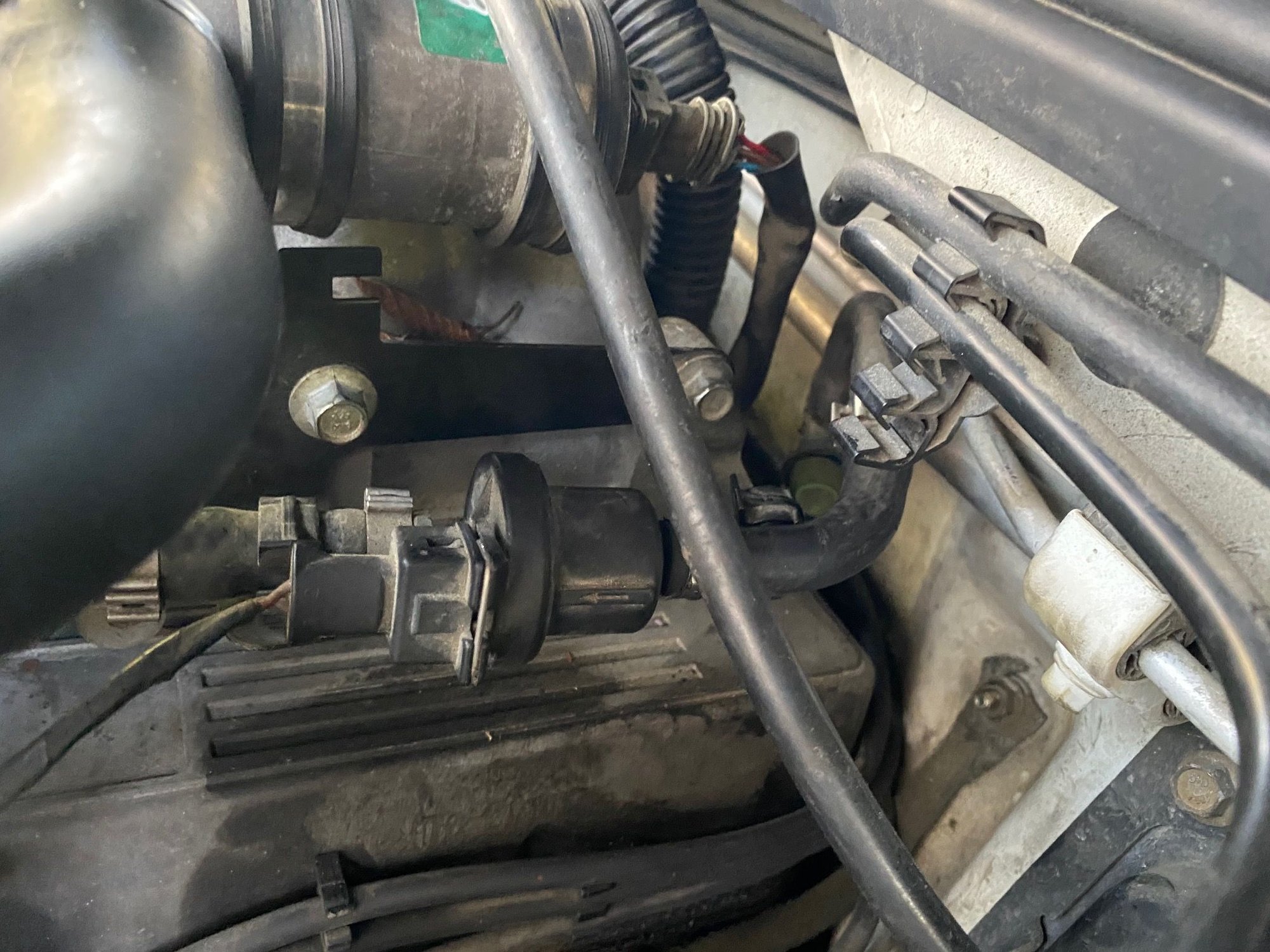

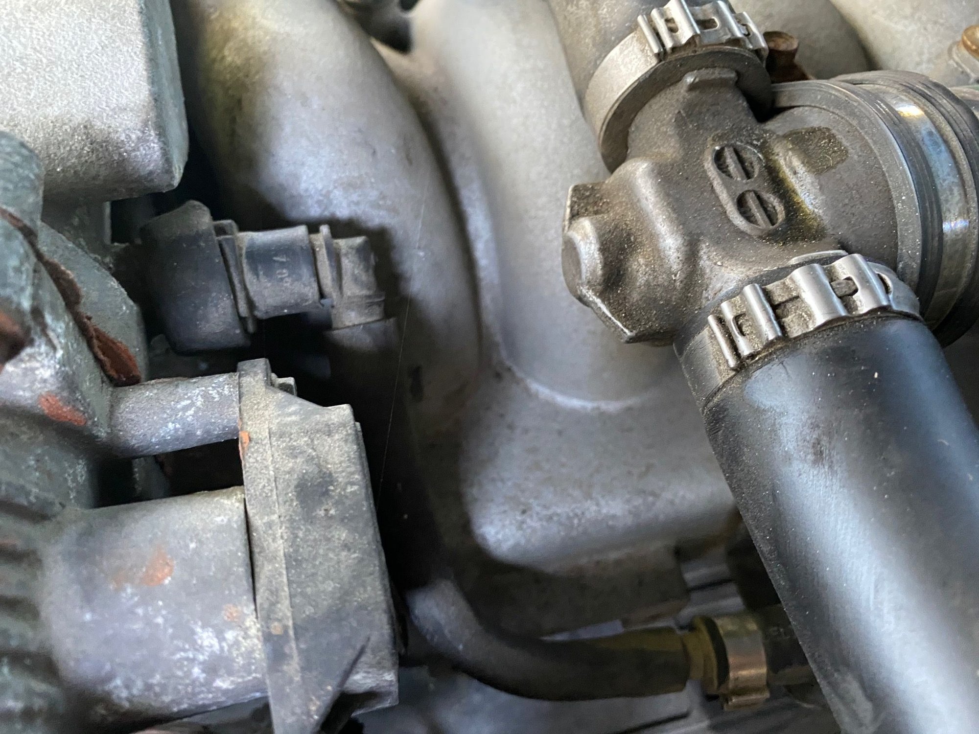

I think it was just air or gunk in the gas line and possibly a weak pump. What confused me is because I could see fuel coming out of the pump at the pump if I pulled the fuel line, but up by the firewall I wasn't seeing any fuel... however I think I was looking at the wrong Schraeder port (see pics below): I think this was actually the emissions check valve (I sorta even says so on the label.. lol EVAC test port). So for future reference folks, WHERE THE FRICK IS THE FUEL PRESSURE TEST PORT?

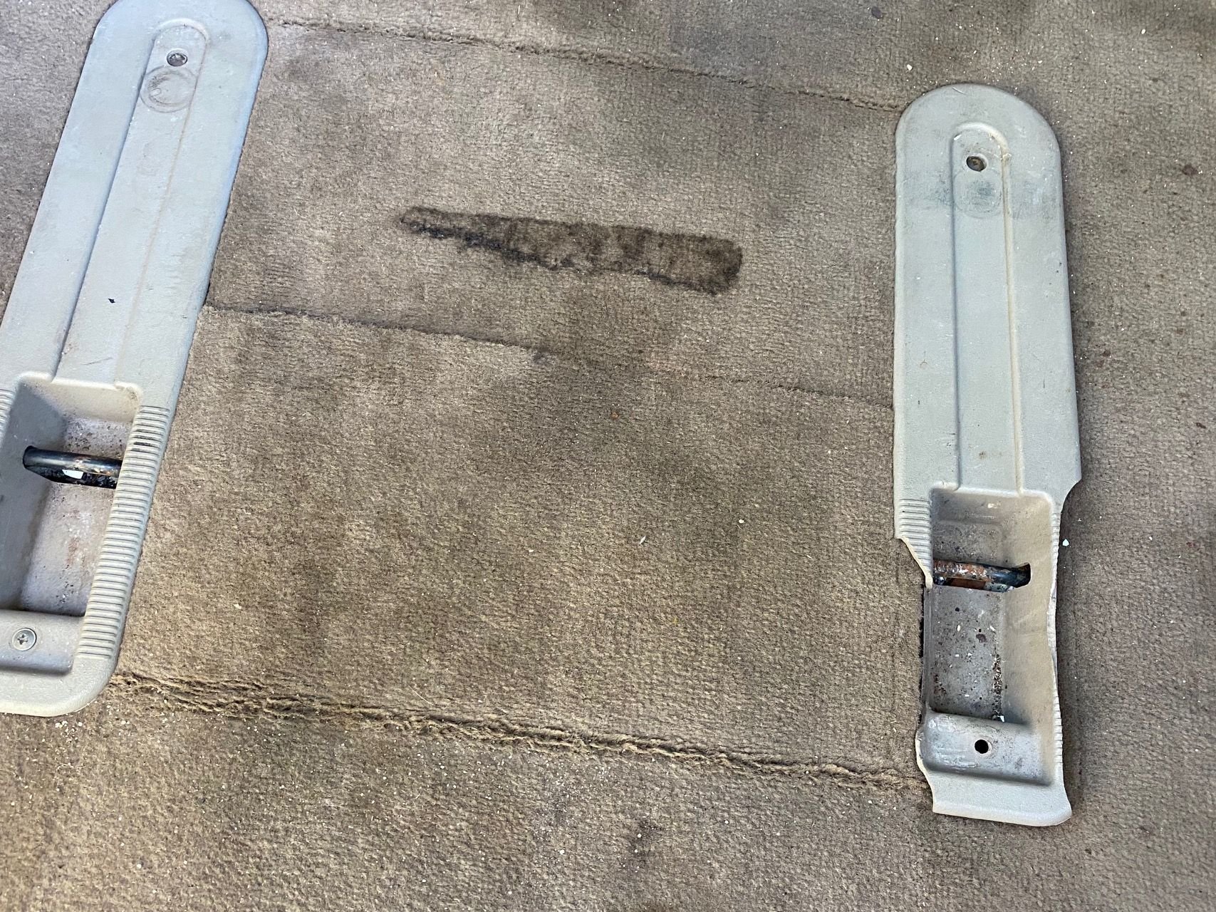

Anyway, here's a pic of an easy, clean cut for the carpet to get to the fuel pump as well. I don't know why most people don't do it this way.. one simple straight line cut and it looks and works great. just pop off the two covers and it opens barn door style.
