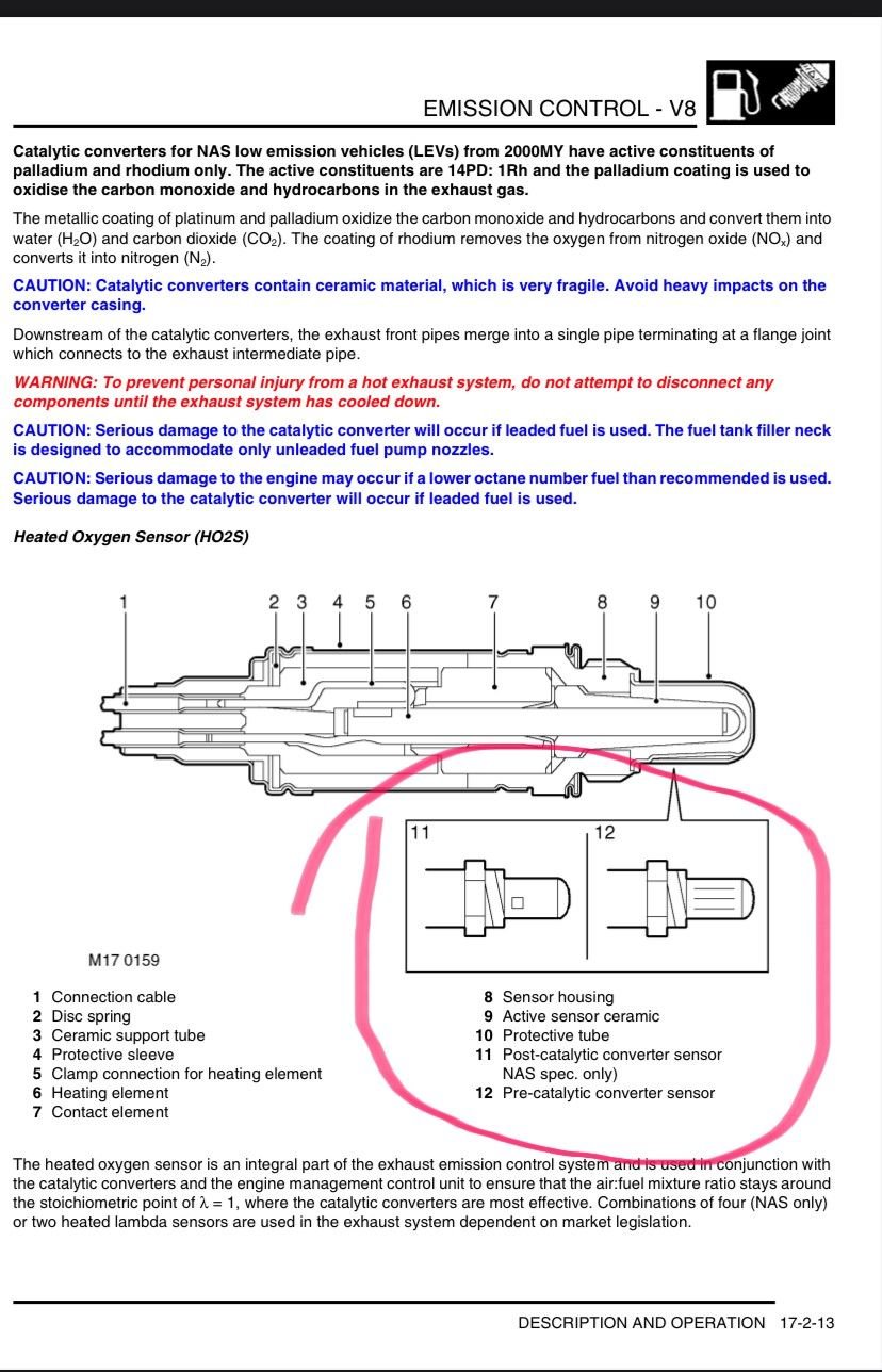

Old Sep 9, 2021 | 08:57 PM
Ben88's Avatar
Joined: Aug 2021
Posts: 13
Originally Posted by Extinct
The plugs are different, one is female and one is male.
I was referring to this (min both look like the 11 instead of looking like the 12)
