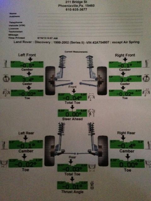

So, I decided to take it in for an alignment prior to installing the ball joints.
Just picked it up and results are below. Side note: Castor is now good (thanks to the 3 degree TF castor correcting arms).
As you can see the the alignment is w/in spec. They didn't have to adjust anything. But, I still have the same symptoms.
Steering wheel is off to the left and truck pulls to the right.
What is wrong w/ my rig? Ball Joints? Steering Box? Steering Linkage?

Most of the time it's tires that cause pulling if your suspensions and steering is ok. If your tires aren't directional you could try swapping them side to side and see if the pull changes directions or goes away.
Lifting it could put your steering wheel off, even if your alignment is good. You could have them install the bolt that centers the drop arm (pitman arm) in the steering box and attempt the alignment again. If its off have them adjust it with the box pinned like that. And then they might have to adjust the steering wheel to match.

Tires are fairly new. It just started to pull two days after I installed the TF radius arms. Before the radius arms it tracked perfectly straight.
I'll have to research more on this pitman arm/steering box. I have an incline that's where the problem lies.
