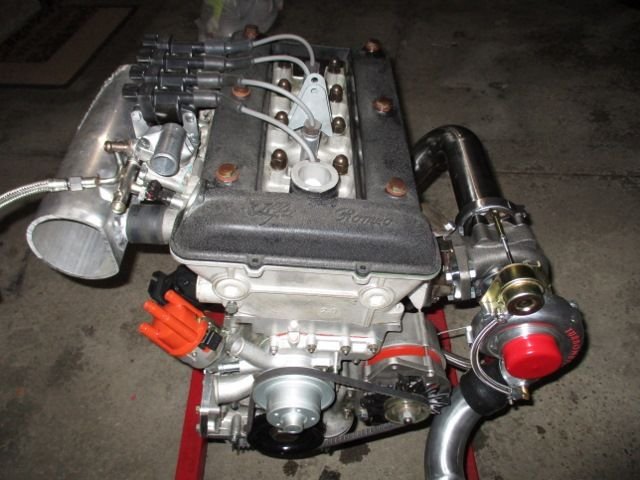

Not to sidetrack too much but here are two pics of my last turbo build:
