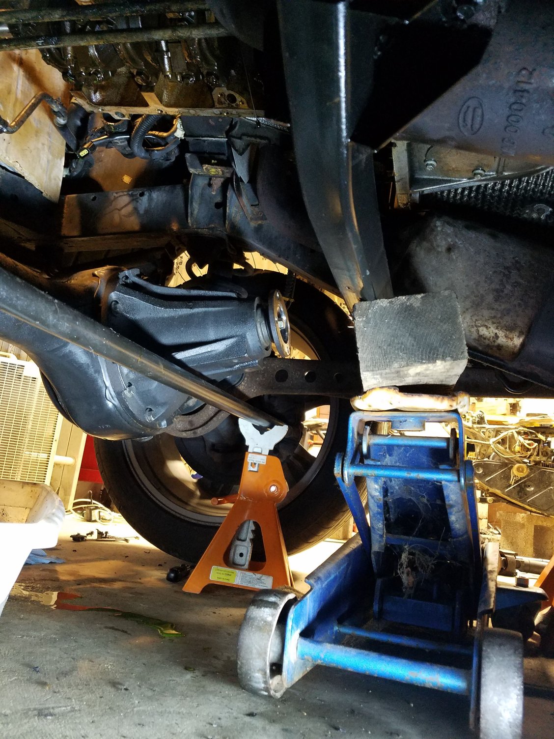

Also, to remove the oil pan, jack up the suspension(for axle clearance for pan to come down), turn the pan backwards, and bring it out the rear driver's side.
It can be awkward getting the pan in or out until you figure out how to turn it, but once you do, it moves in and out easily(jack doesn't look safe in picture, but truck is resting on jackstands, and jack is lowered just holding the block in place).
